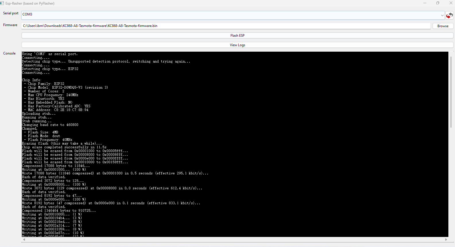

i have use Esp-flasher tool to download BIN file, no any problem.
[attachment=4698]
make sure your computer connect internet well, when downloading, will load some files from cloud server.
(03-12-2024, 04:43 AM)admin Wrote: [ -> ]i have use Esp-flasher tool to download BIN file, no any problem.
