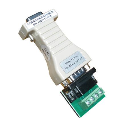

you can just use RS232 to RS485 adapter. our RS232 use pin2,3,5 just TXD,RXD,GND. you just need connect these 3 lines is ok. why you need convert to TTL level? you just chose RS232 <-> RS485 adapter is ok.
I  also  used  that  converter  (RS232 to 485 )  the  results  still  did not  show  the  data  then  I  back  to  test  step  by  stey  from RS232  .
if you want to test RS232, you just use a USB-RS232 cable connect board with PC, you can send and receive command.

yes, this is test ok, then if you want to use RS485, just connect a RS232-RS485 adapter is ok.
[attachment=403]
(11-16-2021, 12:23 AM)admin Wrote: [ -> ]yes, this is test ok, then if you want to use RS485, just connect a RS232-RS485 adapter is ok.
Thank you ,is  female  adapter  ?. I  also used as  this   to  read  modbus  huminity and  temerature but  the  value results   were   0  so that  I  tested  backward  from rs232 to  TTL (Max232)  then connecting  TX,RX  at  the  MAX232 to  verify   ,the  result  did  not  show  as  the  last so  I  think  the  result  must  be  same  as at  the  rs232 port  so  in  this  case  can use  MAX232  or can  any ?.
just find a RS232-RS485 adapter is ok, some seller will have female-male convertor, if not have, you can use 3 line connect with PIN2,3,5 from two interface.
(11-16-2021, 03:02 AM)admin Wrote: [ -> ]just find a RS232-RS485 adapter is ok, some seller will have female-male convertor, if not have, you can use 3 line connect with PIN2,3,5 from two interface.
I  have  done  by   RS232 9 Pin Male to Male 1.5  M  Conductor connecting  to  RS232/485  read modbus device  but no  result and  then  used  Max232  to  verify   ,still  no output display  ,in the  first  time  I  think  may  be  Max232  has  the  problem  then  trying  new  one  Max232  ,still  no  output  display ,the  process  testing  as  the  same  testing  at  RS232 port  the   result  should be  the  same ,  I  will  ask  you  this ,  why  ?. I  focus  for  RS485  because  it  can communicate  many  devices , long  range ,stable  that  suitable  in all  applications  even if  the product  A4  has  4-20 mA  (ADC) .
this week when have free time, make a video tour for you. how to use KC868-A4 RS232->RS485 communicate with third device.
