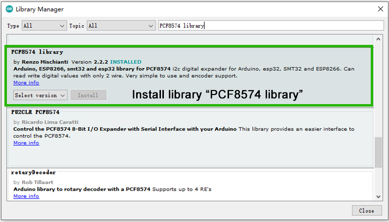

Full Version: [Arduino IDE demo source code for KC868-A8]--#03-ADC INPUT
Code 2: //The demo code is ADC INPUT    You can copy the code to your Arduino IDE
#include "Arduino.h"
#include "PCF8574.h"          //install library "PCF8574 library"

[attachment=510]
