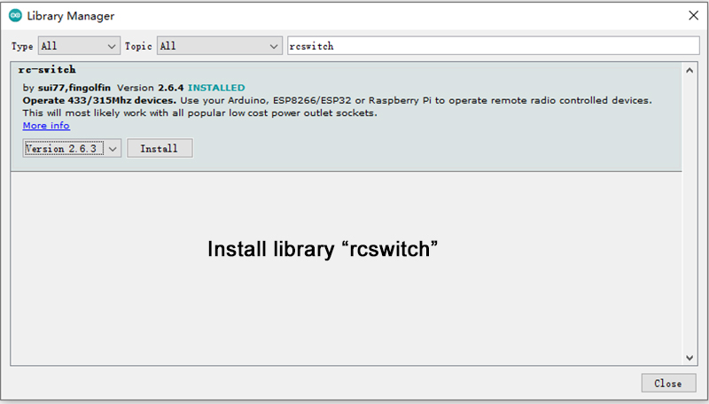

Code 8: //The demo code is RF-send  You can copy the code to your Arduino IDE
#include <RCSwitch.h>

[attachment=518]
