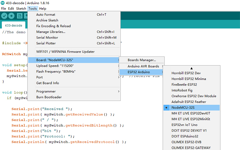

Full Version: [Arduino demo source code for KC868-A4]-01 config Arduino IDE for ESP32 module
 Before using KC868-A4, you need to set the parameters of the preference
Copy the following URL:https://dl.espressif.com/dl/package_esp32_index.json
[attachment=539][attachment=540][attachment=542]
