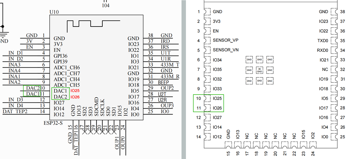

Code 5: //The demo code is DAC    You can copy the code to your Arduino IDE
#define DAC1 26   //DAC1 IO26
//#define DAC2 25   //DAC2 IO25

[attachment=550]
