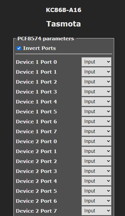

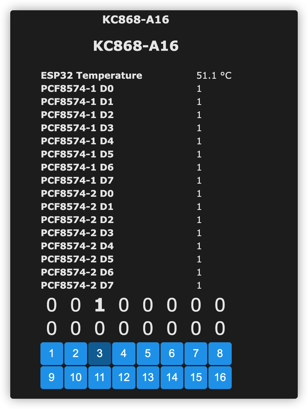

PCF8574 GPIO config for 16 channal output and 16 channel input
[attachment=643]
[attachment=644]
