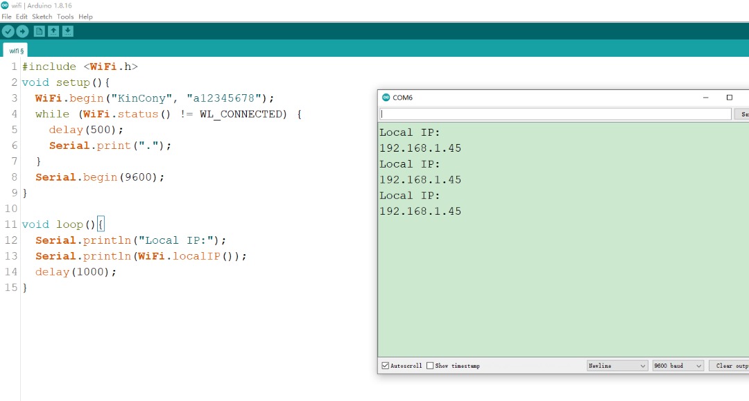

#include <WiFi.h>
void setup(){
  WiFi.begin("SSID", "PASSWORD");
  // SSID and password is the router you want to connect
  while (WiFi.status() != WL_CONNECTED) {
    delay(500);
    Serial.print(".");
  Serial.begin(9600);
void loop(){
  Serial.println("Local IP:");
  delay(1000);
[attachment=786][attachment=787]
