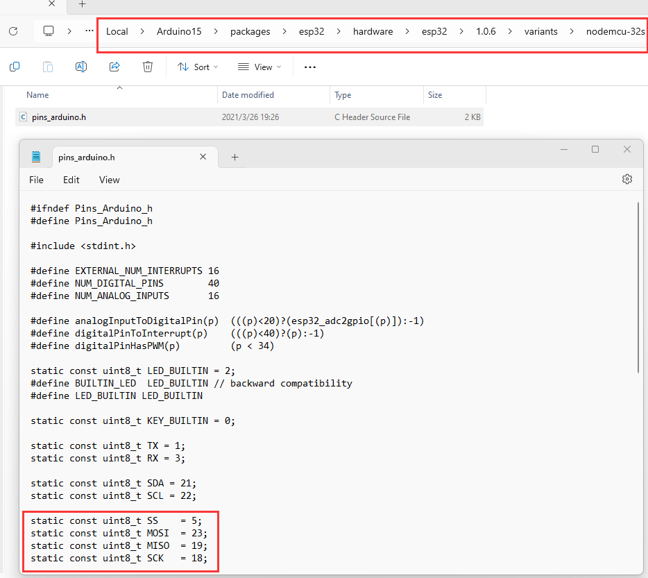

/*SX1278_sender code for KC868-A6*/
#include <LoRa.h>
#include <SPI.h>
#define ss 5
#define rst 21
#define dio0 2
int counter = 0;
void setup()
  Serial.begin(115200);
  while (!Serial);
  Serial.println("LoRa Sender");
  LoRa.setPins(ss, rst, dio0);    //setup LoRa transceiver module
  while (!LoRa.begin(433E6))     //433E6 - Asia, 866E6 - Europe, 915E6 - North America
    Serial.println(".");
    delay(500);
  LoRa.setSyncWord(0xA5);
  Serial.println("LoRa Initializing OK!");
void loop()
  Serial.print("Sending packet: ");
  Serial.println(counter);
  LoRa.beginPacket();   //Send LoRa packet to receiver
  LoRa.print("hello ");
  LoRa.print(counter);
  LoRa.endPacket();
  counter++;
  delay(2000);
[attachment=886][attachment=885][attachment=885]
