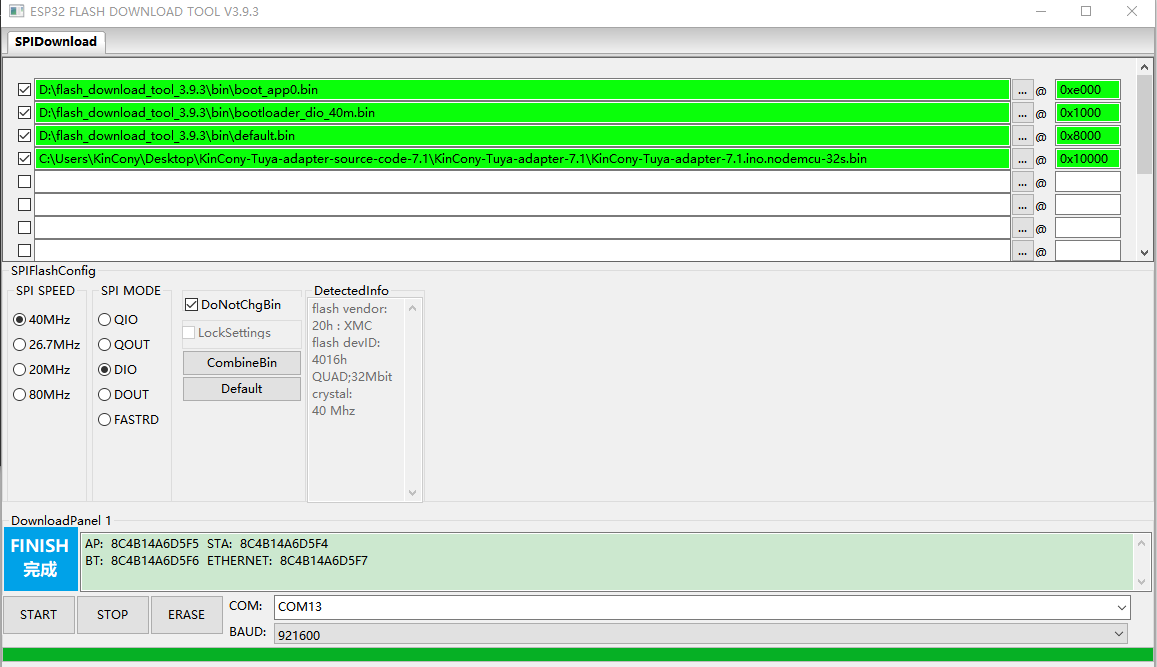

this 7.1 source code version, have added TCP connection with KinCony's relay board by WiFi. so now you can use RS232 or RS485 or WiFi connect to KinCony's KC868-H32BS, KC868-H32B, KC868-H32L, KC868-H32 relay controller.
just config relay board IP port for router by KC868-Adatper's AP (AP name is KC868-Tuya) webpage.
here is firmware BIN file, you can download to ESP32 directly by USB cable:
[attachment=1466]
here is arduino source code:
[attachment=1467]

here is new BIN file can download to ESP32:
[attachment=1872]
[attachment=1873]
[attachment=1874]
[attachment=1875]
config ESP32 wifi firstly, then you can set relay controller's IP and Port in ESP32 webpage. make sure your relay controller work mode= TCP Server. if you don't want to use by TCP connection, you can set to RS232/RS485 mode, then you can begin config Tuya wifi.
all firmware files download:
