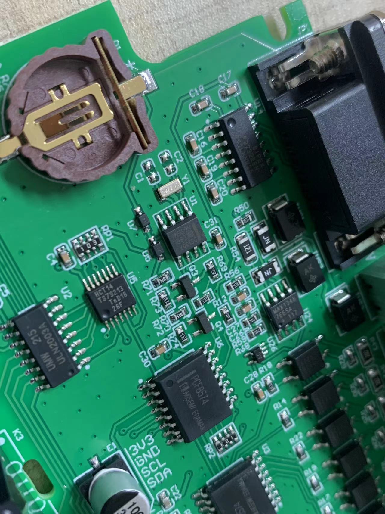

Looking closely at the circuit board, just near the DS1307 chip, the capacitors C1 and C2 are missing.
Would this be the issue?

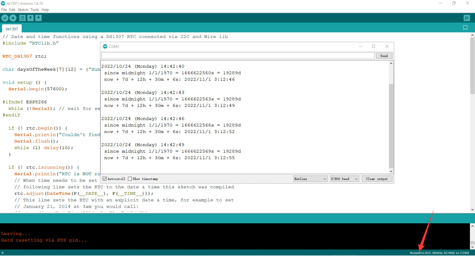

we have tested, not C1,C2 problem. C1, C2 not need to use. you can download our BIN file directly to test.

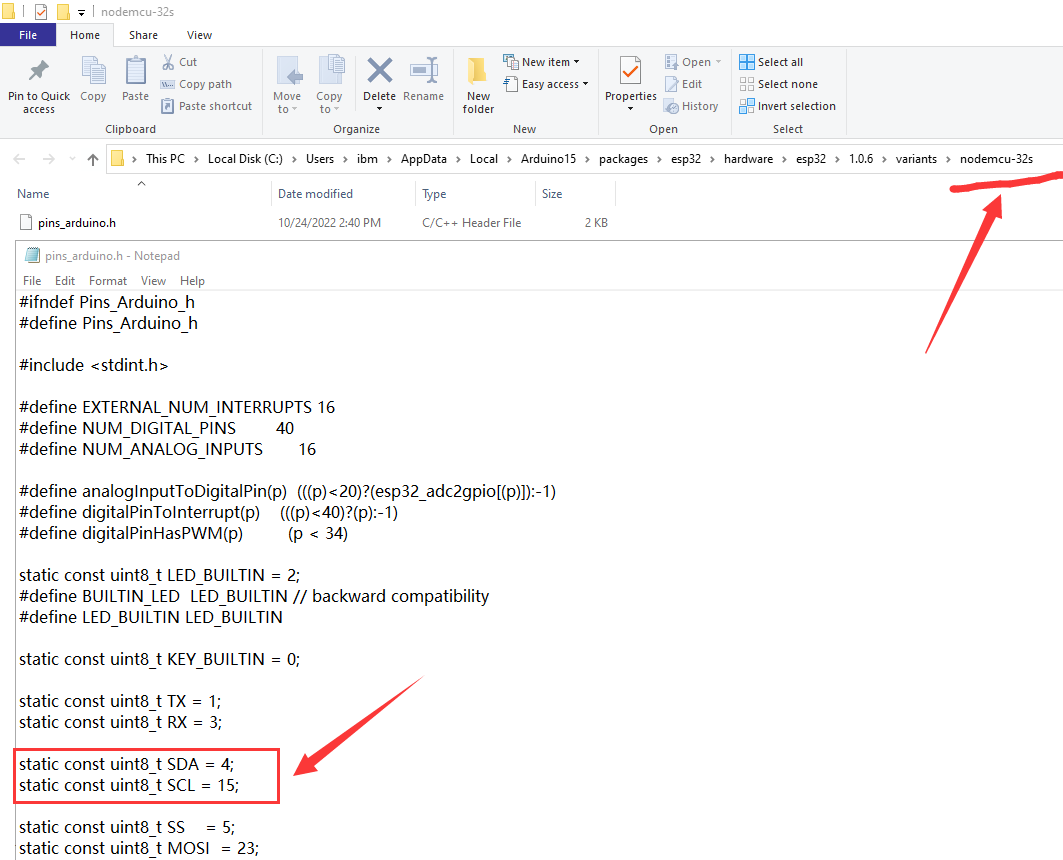

- I've been adjusting the SDA and SCL in the pins_arduino.h file

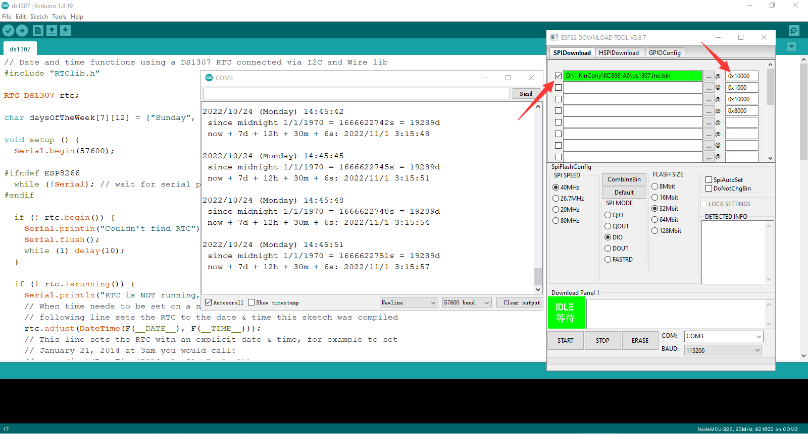

download bin need to set address.
if you really can't work, you can compile in arduino ide export a BIN file upload to here, i download it see whether KC868-A6 RTC work well.

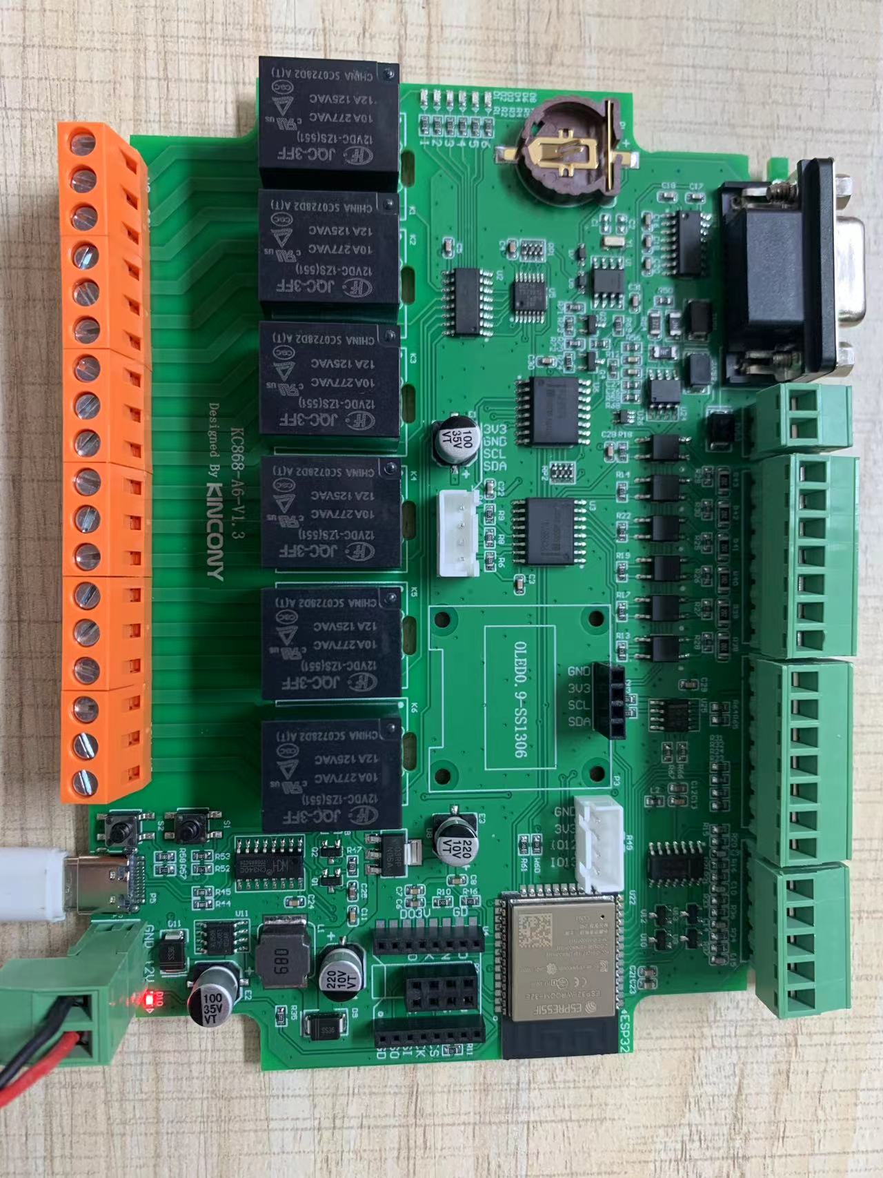

Can you compare my photos carefully to see if there are any missing components on the PCB board.
Hi again
I've looked over the board and I can't see anything missing or any cracks in any tracks etc.

tested your BIN file, work well. make sure download to 0x10000 address, see the photo.
[attachment=1572]
