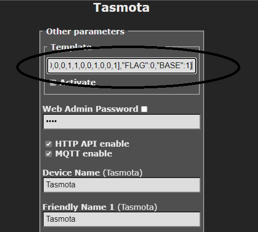

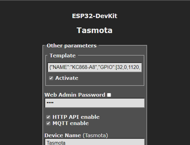

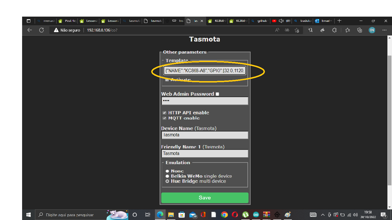

exactly, I have another board and it worked, in this not, I realized that whenever saved, changes the configuration, different from the tutorial , does not save the last settings
{"NAME":"KC868-A8","GPIO":[32,0,1120,0,640,608,0,0,0,1,1,1152,0,0,5600,0,0,0,0,5568,0,0,0,0,0,0,0,0,1,1,0,0,1,0,0,1],"FLAG":0,"BASE":1}

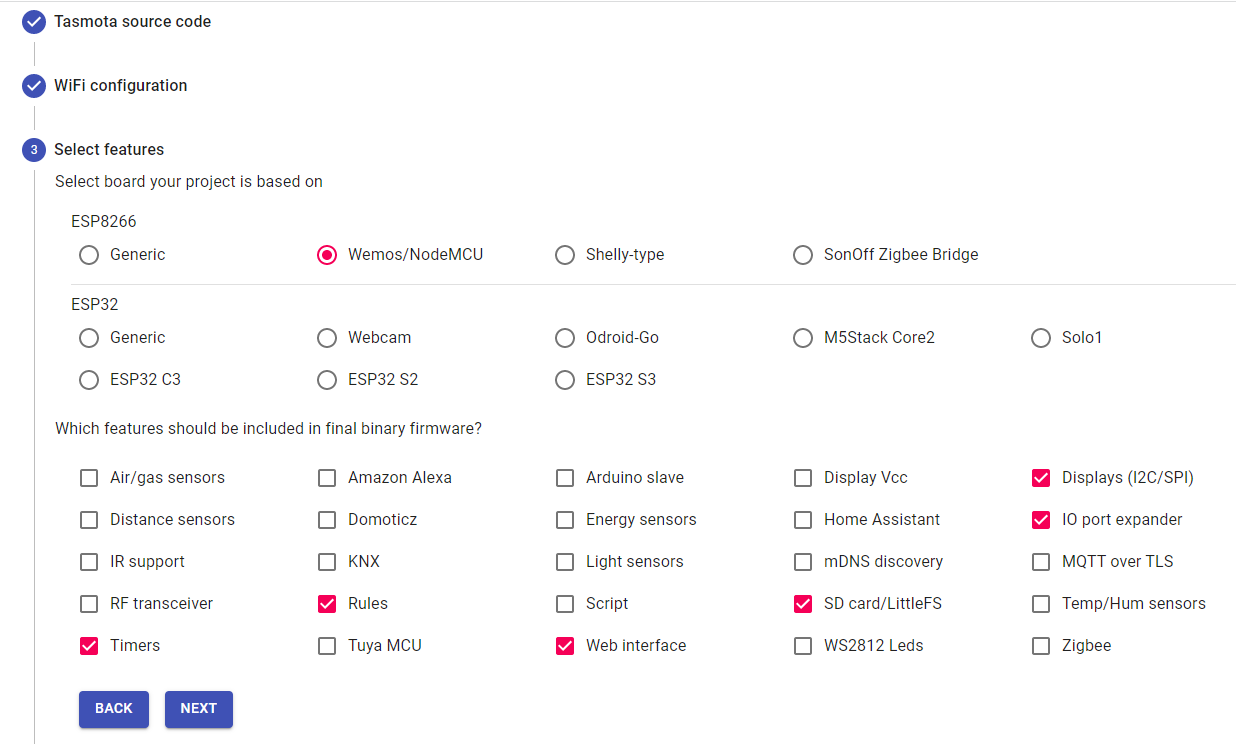

I understand, how can I get the tasmota wifi firmware for the A6?would have some step by step
I think you can use this tasmota cloud compiler tool to generate firmware BIN file, it's very easy.
https://github.com/benzino77/tasmocompiler

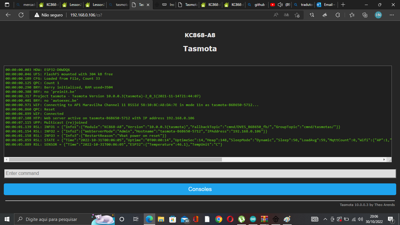

(11-02-2022, 01:28 PM)admin Wrote: [ -> ]you can try to use this firmware. unzip and download BIN file to ESP32.
yes, I already tested what you posted on the forum, but it didn't work, I'll end up giving up, thanks for your attention
