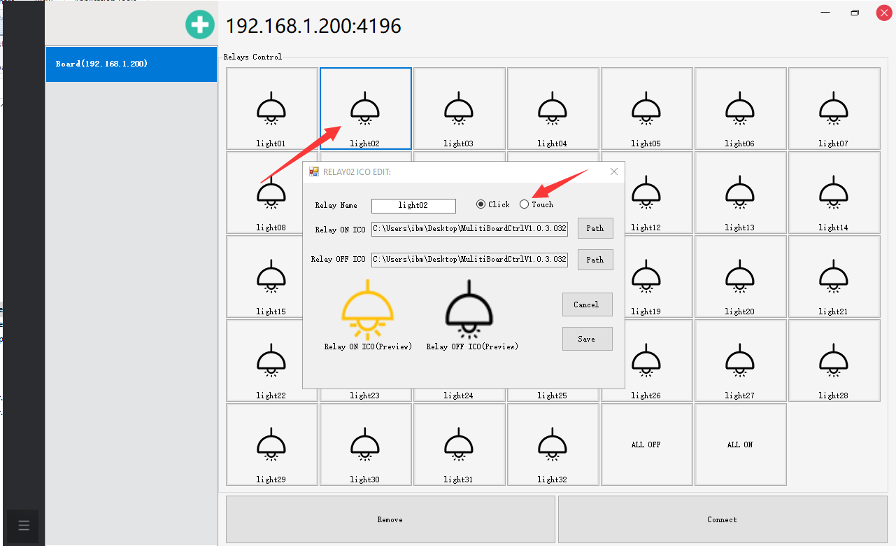

you can use new version PC software , download from: https://www.kincony.com/download/MulitiB...3.0324.zip
it can running on windows PC or 10 inch tablet.
you can set any relay work mode for "CLICK" or "TOUCH"
[attachment=197]
before click "connect" button, use mouse right button click relay ico will see the setting window.

Excellent, this is very nice functionality. Thank you.
