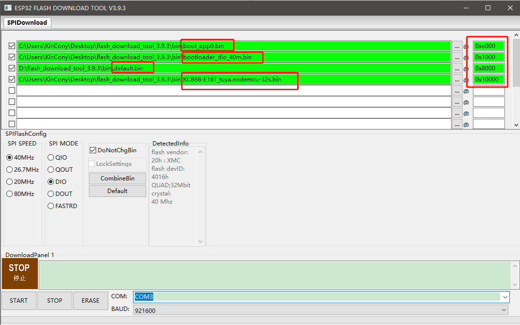

need add 4 files,set the address like the   picture
[attachment=2462]
