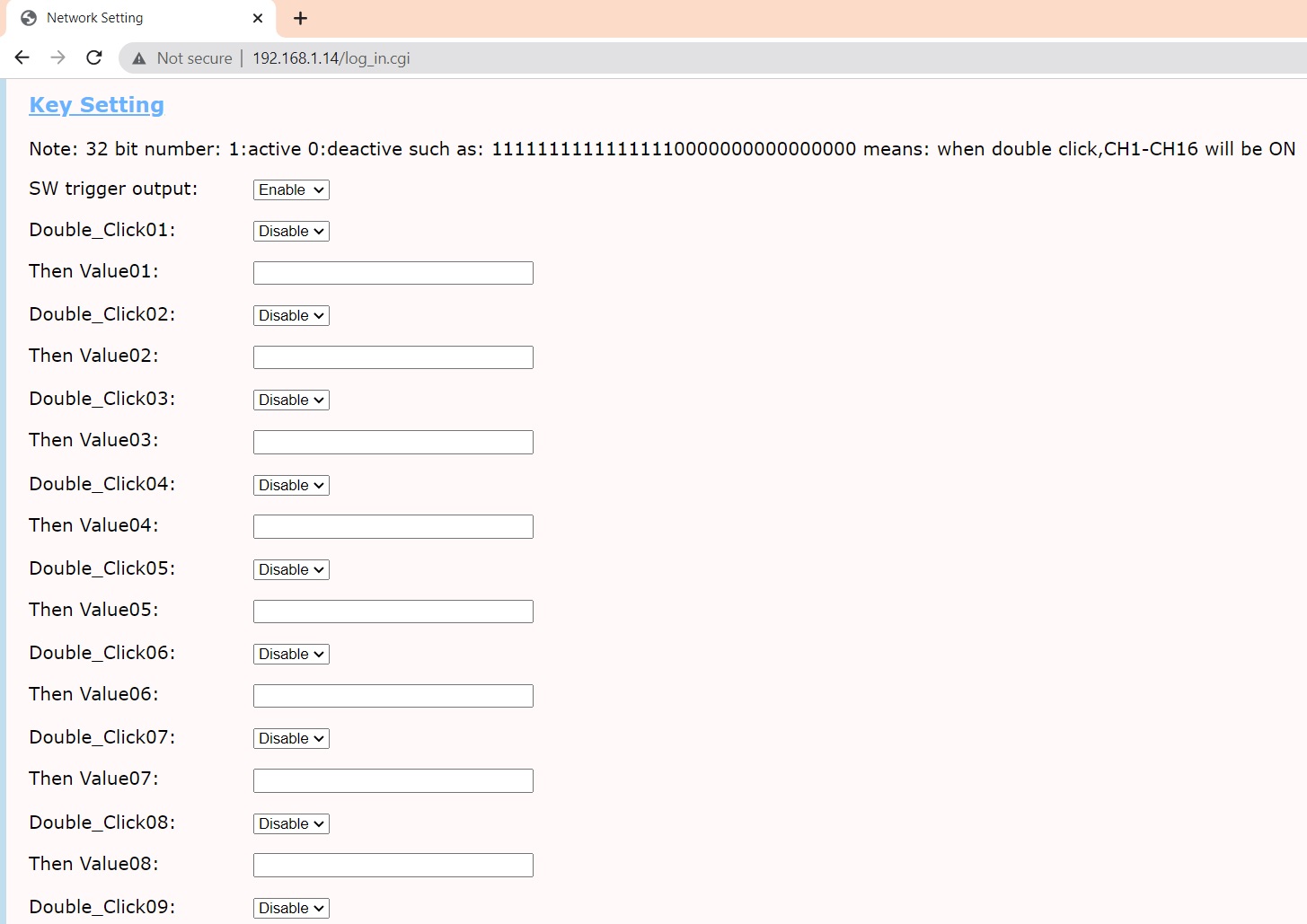

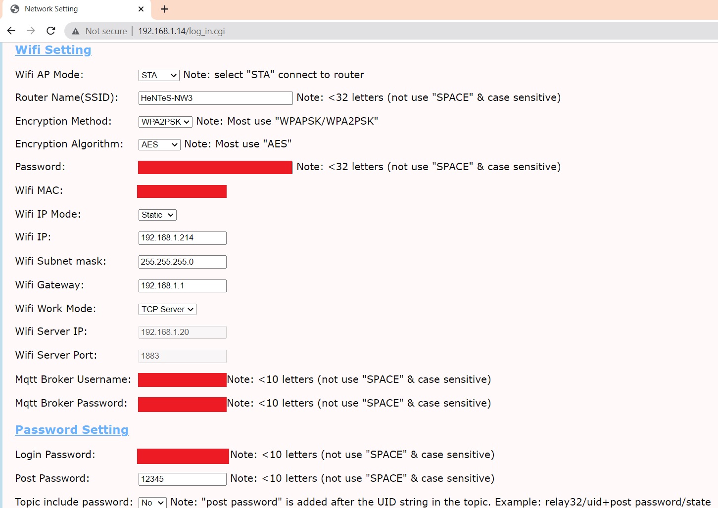

I'm sending 6 pictures. First 4 pictures with all my settings, picture no.5 is home assistant error log from mqtt (H32BS) and picture no.6 is one of my wall switches.
[attachment=1758]
[attachment=1759]

if you want use 1-32 DI with mqtt message, please make sure "SW trigger output" is disable, now i seen in your screen photo, it's "enable".

if enable "SW trigger output", then you use wall switch, will not feedback mqtt message, you received message because relay have changed state, so will auto send mqtt message for all relay, it's not send by DI 1-32.
If you disable "SW trigger output", that means: INPUT not trigger OUTPUT directly, this time, INPUT use for trigger mqtt message. so that you will know which DIx is short with GND or not short with GND.
