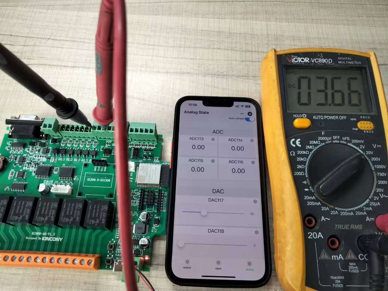

Im Using KCS firmware but on the DAC outpu1 I cannot get any voltage reading when I measure the volts. Also in tuya smart if I change the value of the DAC in the slider it tells me failed to save.
What can I do?

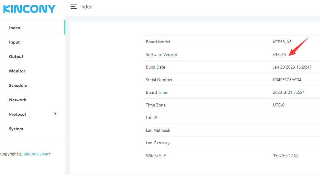

which board you are using? need problem details, take a photo of your software screen is better.
Im using the KC868-A6
Here you can see if I adjust the DAC Which I named Pivot speed 2 it tells me save failed
[Image: attachment.php?aid=2149]
maybe it's internet problem, you can switch your mobile phone by wifi or by 4G for a test. we have tested A6 with tuya, all are work fine.

I tried with my phone on 4g and on wifi bit still givea me save fail error
