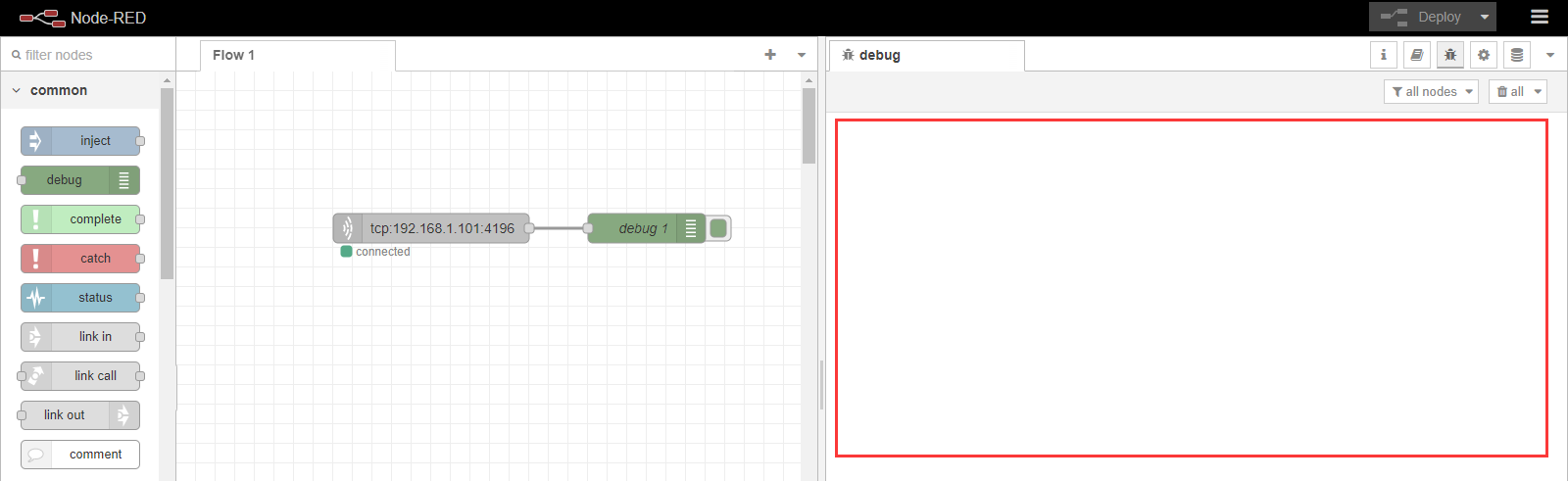

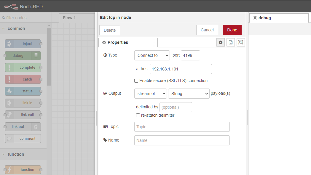

i have use Node-Red with H32B Pro , no any auto feedback. i think there is some home assistant entity always send query command to H32B Pro you have made, so H32B pro will auto feedback. i just only install the Node-Red , work without home assistant.

1. Do you have any update from your testing?
1. Do you see my feedback? no this problem, check your home assistant or Node-red other nodes, must have query for every 2 seconds.
OK, i will re-install HA and node-red again. For clearly
i think you can install only Node-Red for a test firstly.

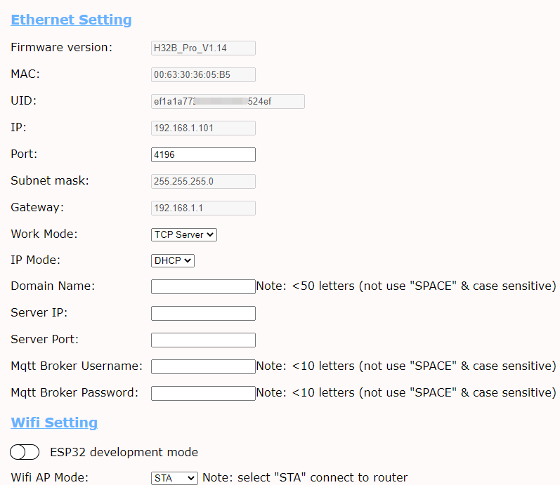

HI, i got the problem now. it stop after i disable esp32 Developer mode in relay setting.
if i turn it on for homekit use, the debug message running. Why, How can we stop it event turn ON Esp32 Developer mode?
you want to use Apple Homekit , but not want the feedback message to TCP ?
yes, i want to use homekit but don't need feedback message.
ok, we will check, then feedback to you.
here is new firmware updated for KC868-H32B Pro for this problem. you can test it.
