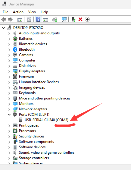

1. Connect with USB-RS232 cable.
2. check COM port in your windows OS "Device manager"
3. fill COM port to bootloader tool.
[attachment=1995]
(03-01-2023, 08:05 AM)admin Wrote: [ -> ]1. Connect with USB-RS232 cable.
i checked and updated but still same error. see image
maybe your port is occupied. you can reboot of your computer for a test. if also have problem, you can try to use another computer.
