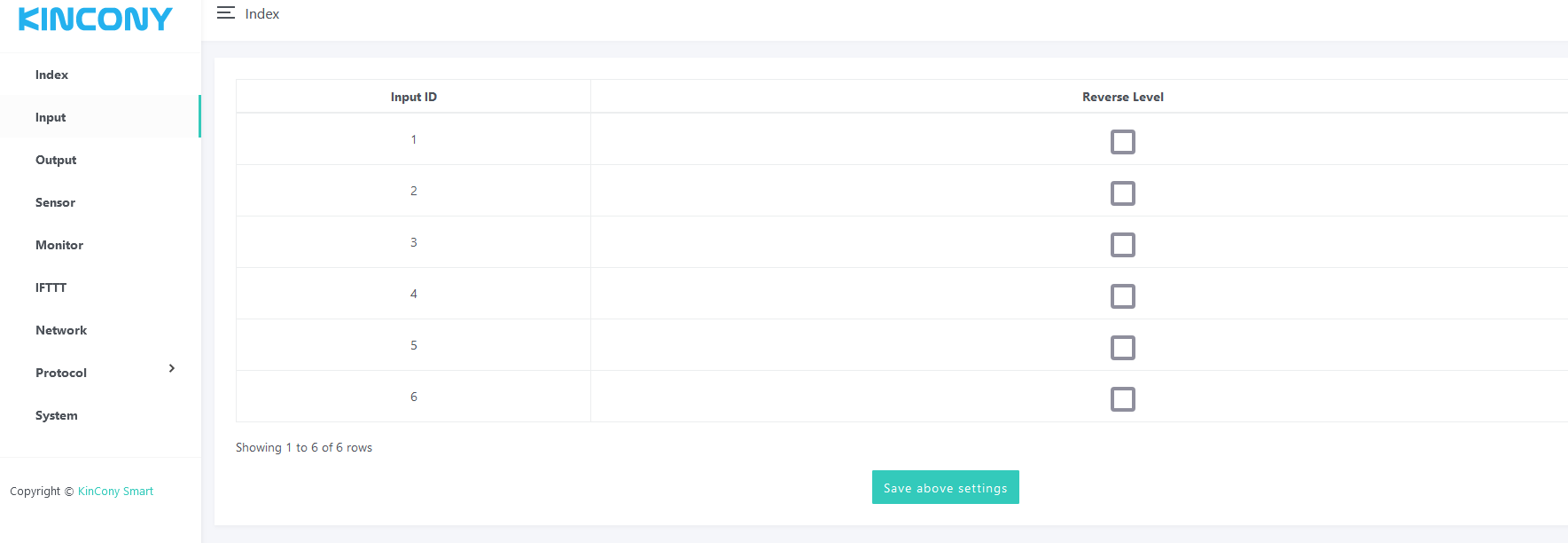

The layout on "https://www.kincony.com/kcs-firmware-esp32-board.html" is not the same as the layout I have.
See pictures to see the difference.  I tried KCS versions "2.2.2" ; "2.2.7 " and "2.2.10"
Due to this I cannot define buttons.
[attachment=6836]
How can i define the buttons in the KCS?
Best regards
because new version use by IFTTT, just click IFTTT left menu, you can define all INPUT for OUTPUT.
