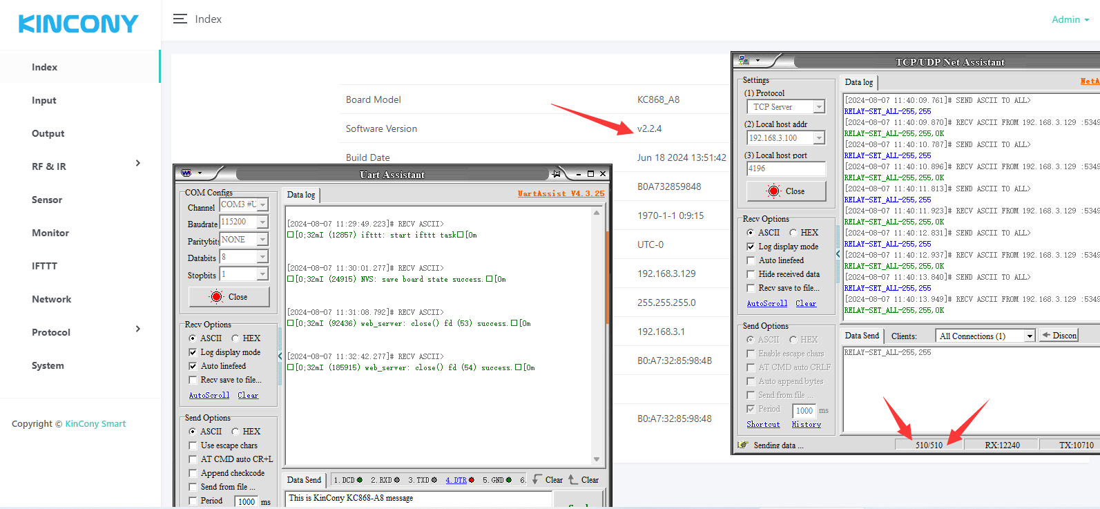

kcs_kc868-a8 firmware v2.2 is very unstable for TCP and UDP protocol communications. often does not connect after successfully sending protocol commands. After restarting it will connect again
we have tested, it's ok, i suggest you can connect to your another router.
i am using TCP Client mode tested about 10 minutes, sent 500 times, no disconnected.
