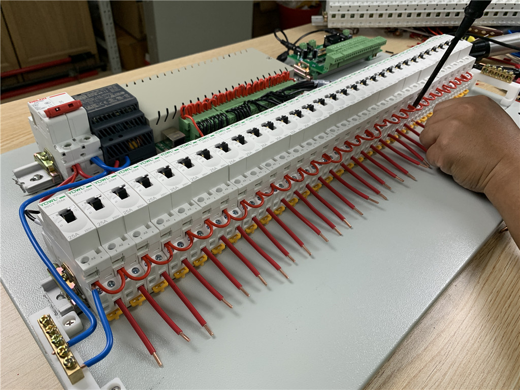

Here is the Smart Home Tech Tour for 32 Channel Distribution Board DIY used by KC868-H32B Smart Controller.
[attachment=15]

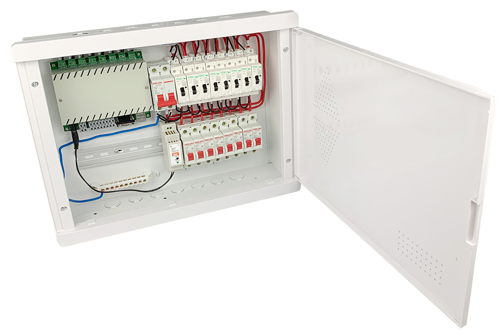

very impressive, i'm looking to make one of these, Im in the uk and firstly would like to know the minimum size of the box as i may be able to get hold of one.
size according to your channel number, such as we mini box for 8 channel size is 42.5*32*12cm.
[attachment=17]
(10-28-2020, 10:19 AM)admin Wrote: [ -> ]size according to your channel number, such as we mini box for 8 channel size is 42.5*32*12cm.
Hello, Im intending to use the H32B, I have purchased the attached
do you have a wiring diagram or clearer picture with a list of part Please? THE SIZE IS 500X500X210
Gay it depend what you wish realize. Always specific for concrete project. Need have basic knowledge about electric modules and they functions as well featurse of load power. If use the loads small power less 1000W I suppose you don't need external contactors, just can use internal relays. If need more help I will help you.
