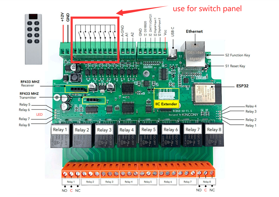

2. KC868-A8 have 8 channel digital input ports, just directly to use, why need solder on PCB?
see this photo, there are 8 channel DI use for switch button:
[attachment=2586]
