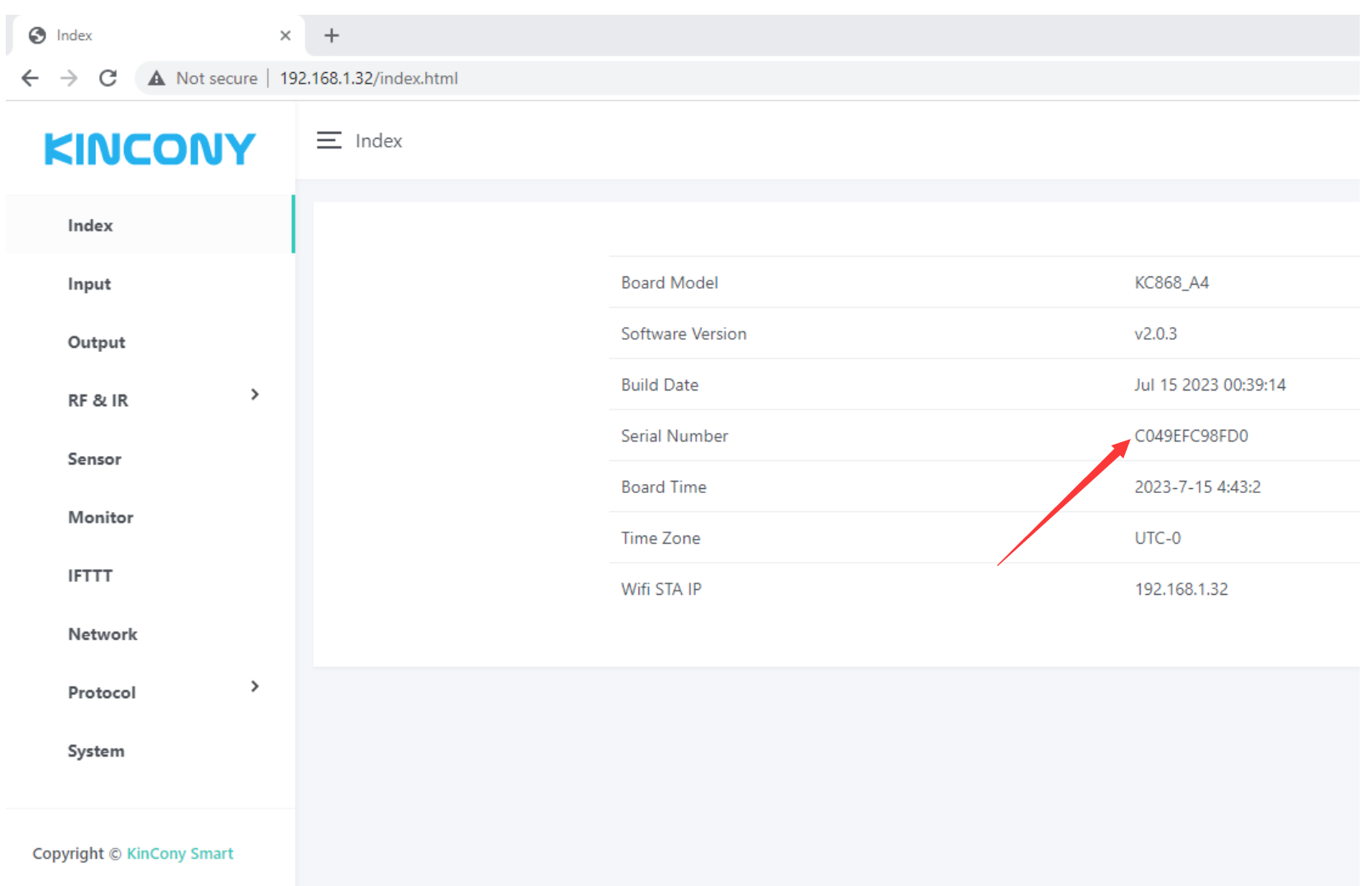

Good day sir, what is the UID for KC868-A16S?
i want to use mqtt but i do not know where to find my A16S UID. Can you give mqtt example code? thank you.
everboard will have a UID. you can check on config webpage, there is serial number.
[attachment=4971]
