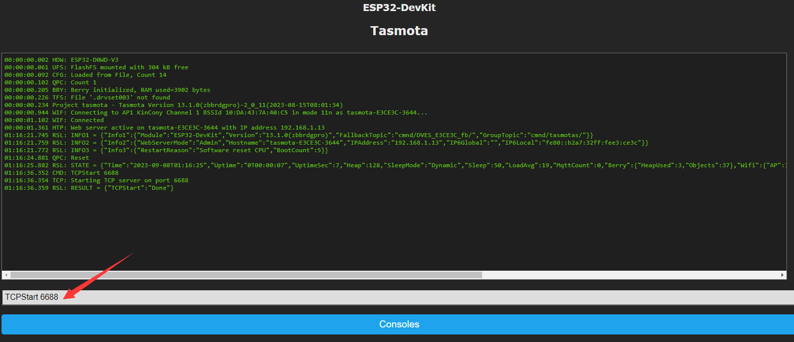

1. run TCP start command: TCPStart 6688
you can also use other port number, 6688 just for example.
2. create a rule when system reboot will auto start TCP command: Rule1 ON System#Boot do TCPStart 6688 endon
3. enable Rule1 command: Rule1 1

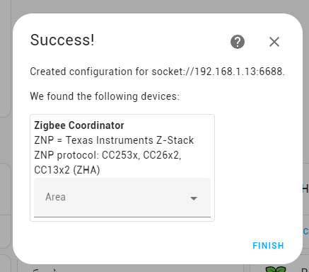

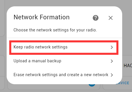

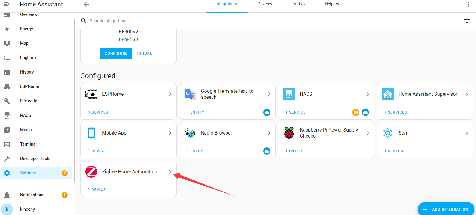

[attachment=2996]
[attachment=2997]
[attachment=2998]
[attachment=2999]
[attachment=3000]
[attachment=3001]
[attachment=3002]
[attachment=3003]
[attachment=3004]
