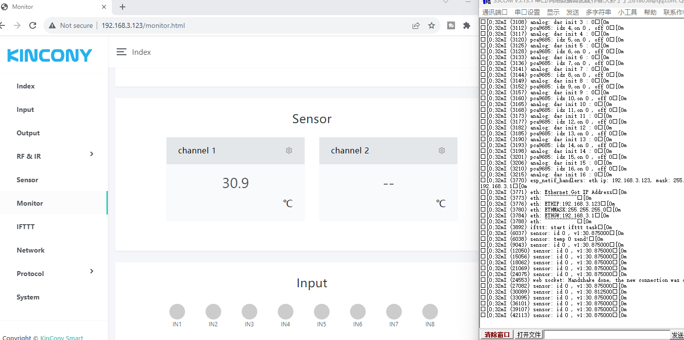

if already "enabled", then you can use this uart tool to monitor USB port, that can see LOG. when you trigger. take a screen photo of LOG.
attachment=3085]
serial port baud is 115200bps.
yes i enabledĀ IFTTT command , pls how to use uart tool ?
PC connect to board by USB cable. open serial tool is ok.
attachment=3089]

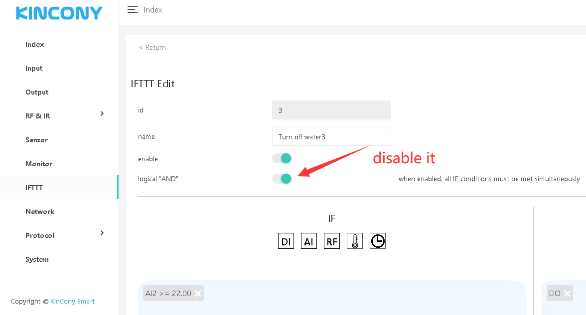

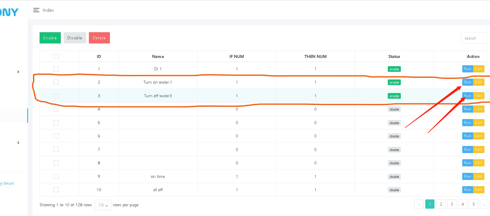

It only responds to the automation for turn on KC868-A8 relays at a certain value, but it does not respond to the automation to turn off the A8 relays when the tank is filled.
take a photo of your IFTTT command.
you need to create two IFTTT command, both been enabled.

Click run to test the settingsĀ
