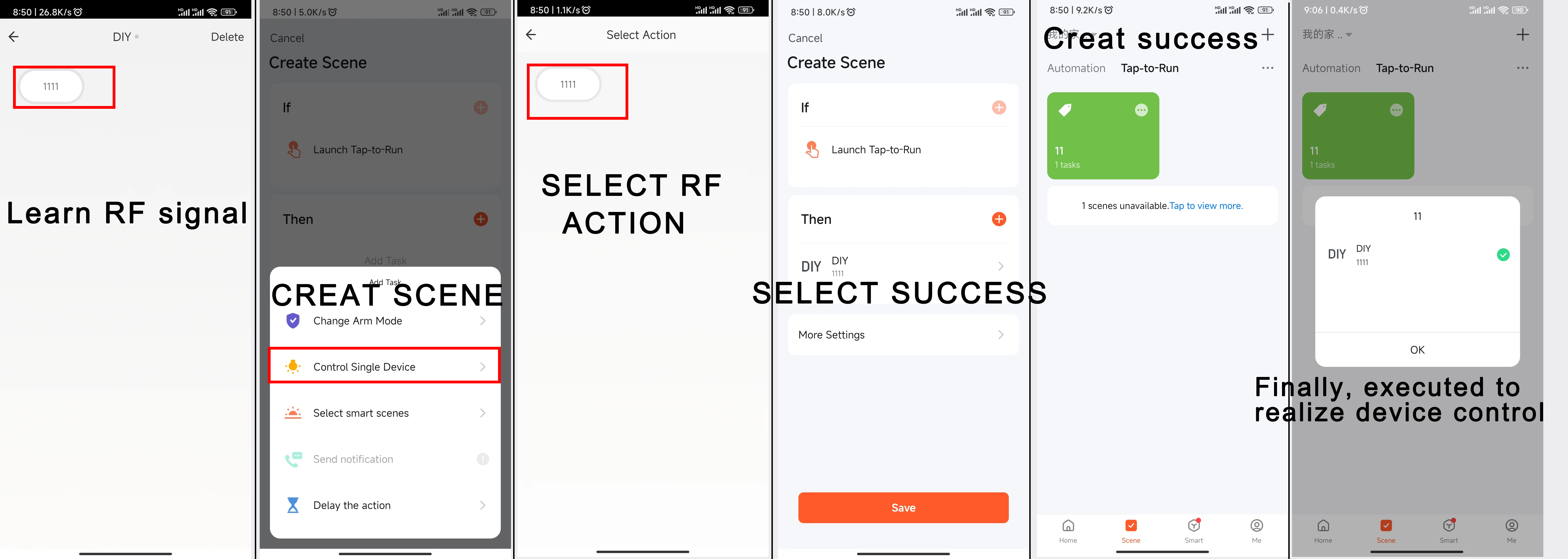

We tested AG-PRO's 433 signal learning and triggering. 433 signals can be learned normally, It can send 433 signals through scene mode
[attachment=3257]
