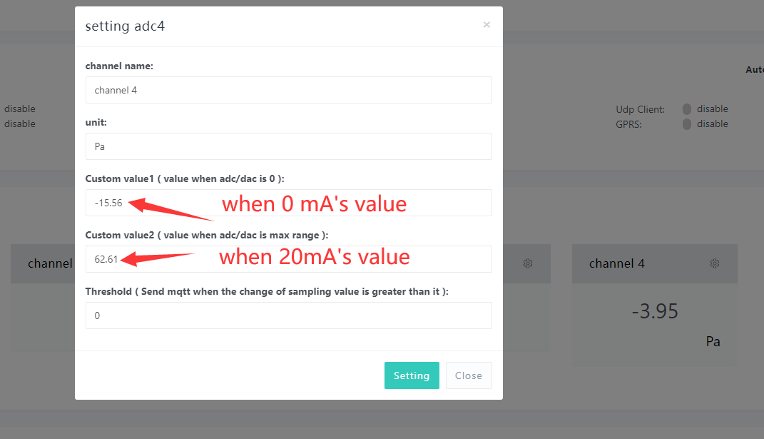

first item is when 0mA's value.
second item is when 20mA's value.
[attachment=3384]
(11-08-2023, 06:05 AM)admin Wrote: [ -> ]first item is when 0mA's value.
