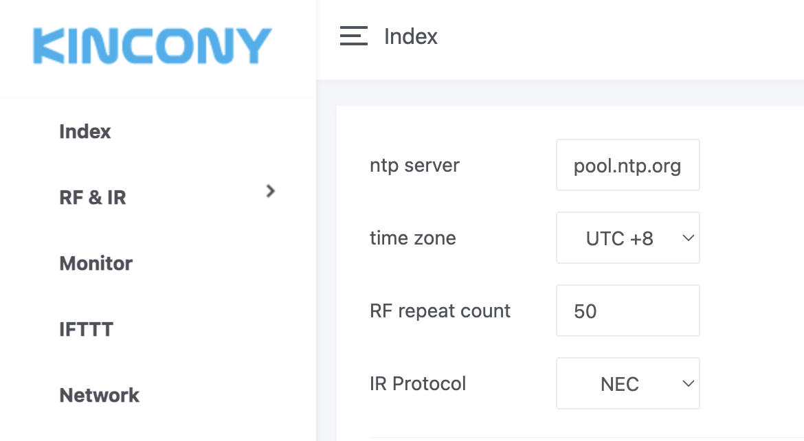

The big problem is NOT that the time is out of sync for some seconds or minutes.
The problem is that the change of UTC does NOT refelct the numbers changed.
I do have tested the NTP server with pool.ntp.org as well as with ntp.metas.ch as used on several other projects without any problems.
[attachment=3956]
To proof the fault.
Zhejiang is in nthe timezone UTC +8. So at the time of this writing, this should show as 18:02.
But If I change the "time zone" in the System on the KC868_AG it is still 7 hours to. low.

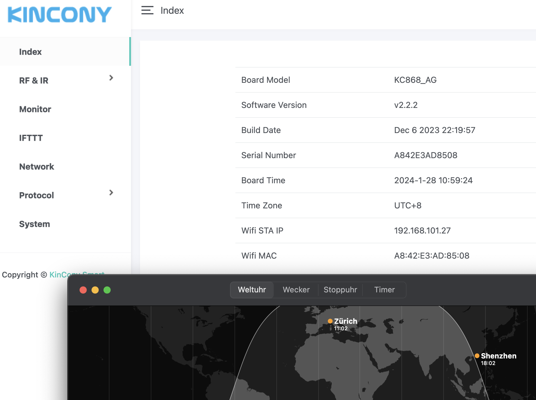

BUT ALSO!!!
If I let the index page open for a certan time, the shwon clock gets slowly out of sync with dropped seconds. Only after a refersh of the webpage, the time is in sync again...
[attachment=3958]
[attachment=3956]
To proof the fault.
BUT ALSO!!!
[attachment=3958]

(01-27-2024, 11:41 PM)admin Wrote: [ -> ]i think you can chose another NTP server in SYSTEM webpage. There are some NTP server on internet. ESP32 board when power on , will get the time zone from internet.
As a proof that the device is getting NTP time code, see this video.
Also you will see, that if I change the time zone to UTC+8 which is the one you are living, even then it's wrong.
It also does proof that you have probably a code failure where UTC+0 is instead shwon as UTC+7.
01-28-2024, 07:52 PM
Hello, I'm facing the same issue in the UTC+1 timezone with a delay of 7 hours. I have tried using several NTP servers without success.
