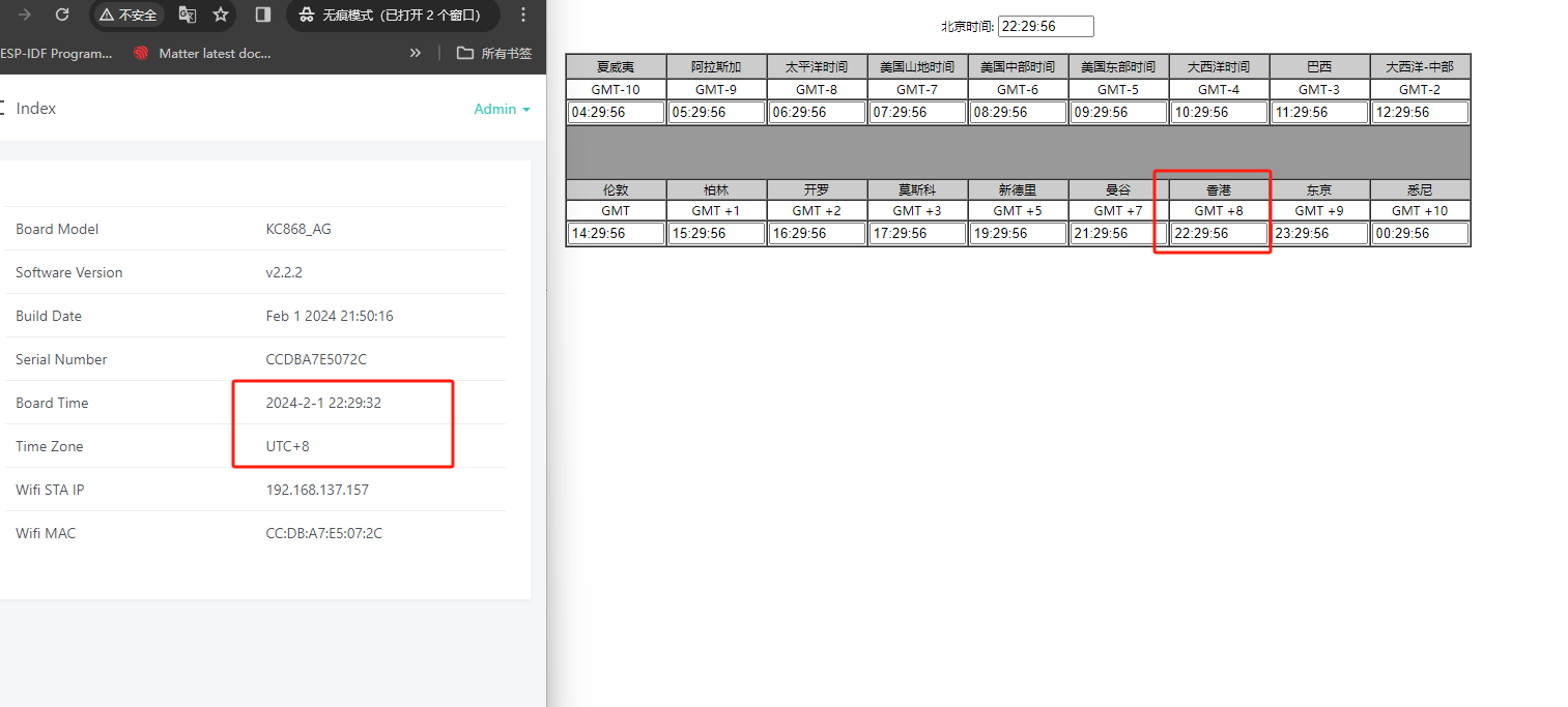

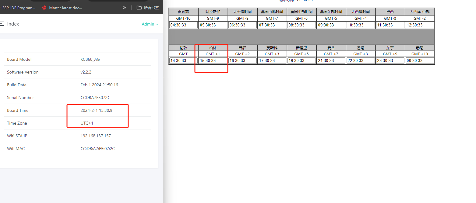

we have tested with UTC+1 , it seems correct. when need have a option for "summer time" or "winter time" ?

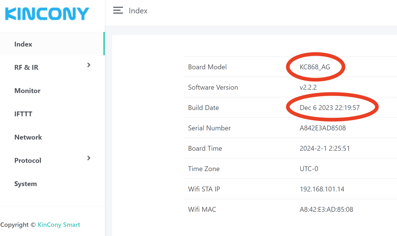

I have some points to mention:
- You did test with an other devices (KC868-ASR) versus the one in questeion (KC868-AG Pro)
- Despite you are using the same Firmware Version 2.2.2, your build date is much newer (2024-1-31) then the one we can download (2023-12-06) and has probably to do with the different used devices. Maybe also that this bug has been fixed between the release dates of the firmware.

here is we tested with AG V2.2.2 firmware by UTC+1 time zone.
[attachment=3987]
[attachment=3988]

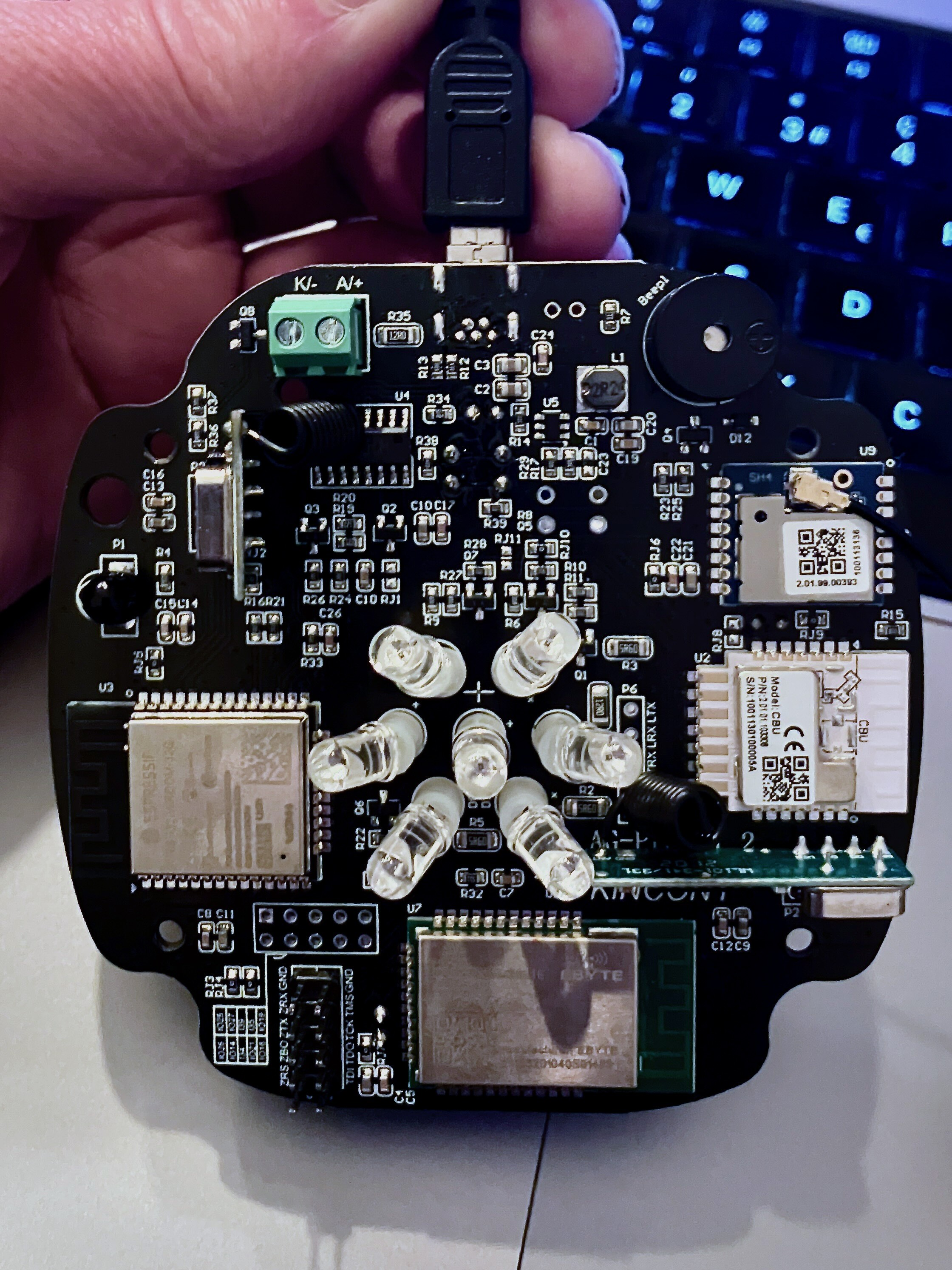

And here some pictures form the PCB of my unit in trouble.
[attachment=4013]
[attachment=4014]
[attachment=4015]
