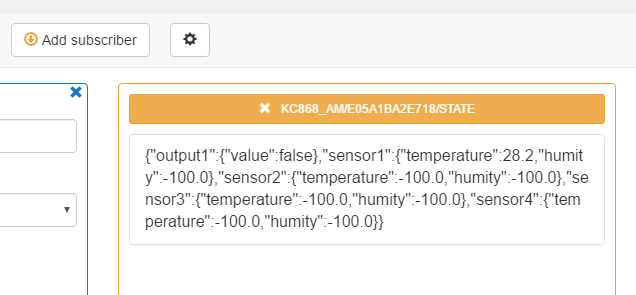

I have noticed in MQTT Explorer that the published MQTT string has an extra comma before "output1". {,"output1":{"value":true},"sensor1":{"temperature":78.3,"humity":-100.0},"sensor2":{"temperature":78.8,"humity":-100.0},"sensor3":{"temperature":78.6,"humity":-100.0},"sensor4":{"temperature":78.6,"humity":-100.0}}
This seems to affect the JSON format so I don't know if it is supposed to be there or is it a bug in the firmware.
I have circled it in red in the image.

06-17-2024, 08:03 PM
You left out the comma between false} and "sensor1"
{"output1":{"value":false}"sensor1":{"temperature":83.3,"humity":-100.0},"sensor2":{"temperature":82.8,"humity":-100.0},"sensor3":{"temperature":82.6,"humity":-100.0},"sensor4":{"temperature":86.9,"humity":-100.0}}

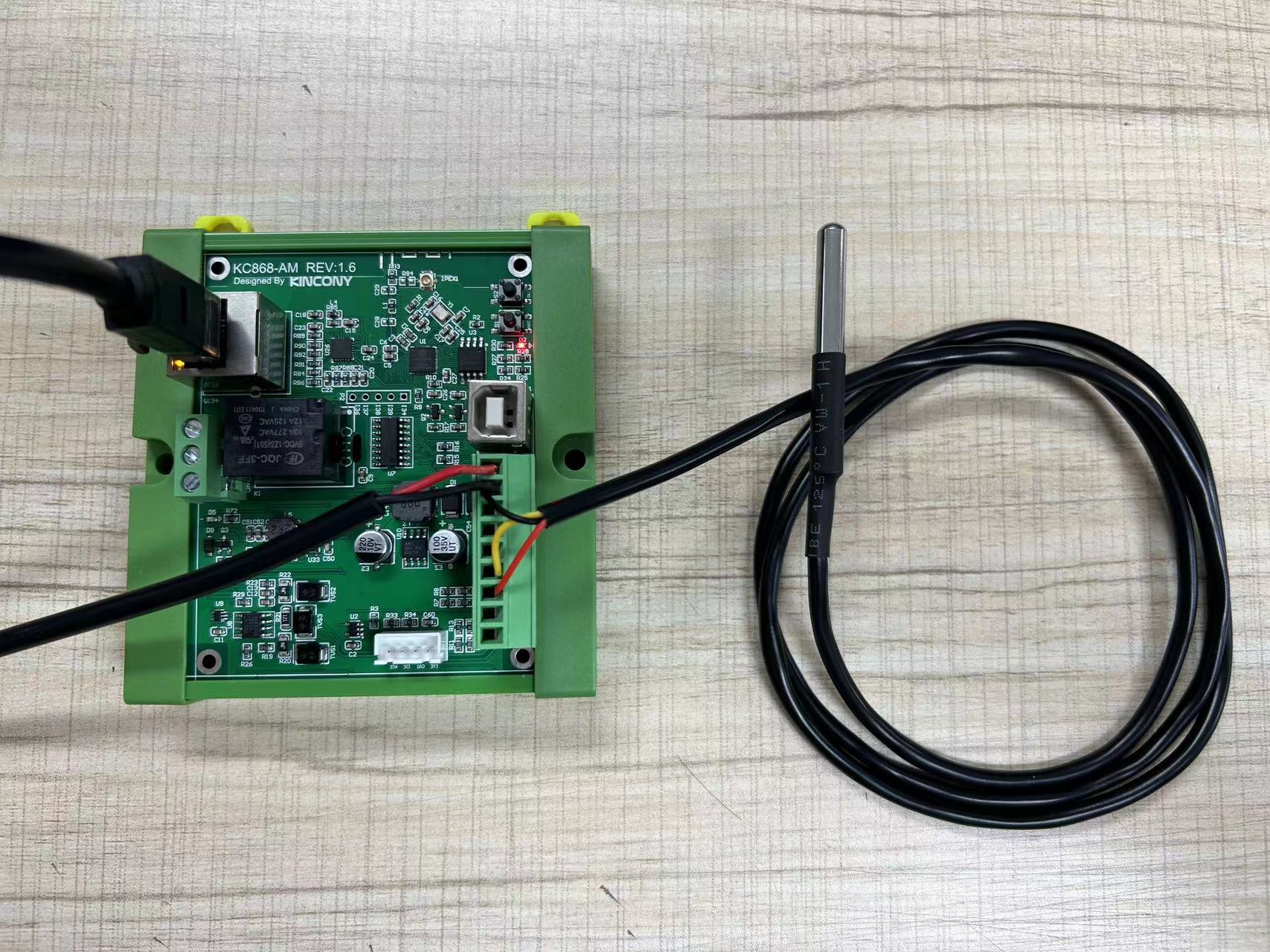

tested as photo:
[attachment=5443]
[attachment=5444]
{"output1":{"value":false},"sensor1":{"temperature":28.2,"humity":-100.0},"sensor2":{"temperature":-100.0,"humity":-100.0},"sensor3":{"temperature":-100.0,"humity":-100.0},"sensor4":{"temperature":-100.0,"humity":-100.0}}
if have value -100.0 that means sensor not connected.
