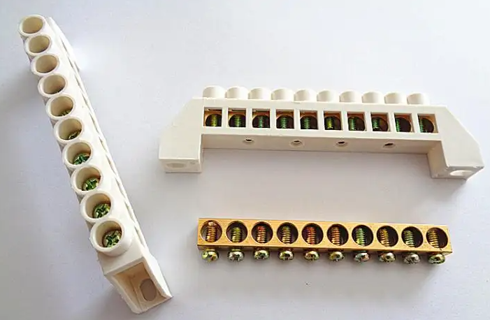

What's the suggested approach to wire neutral?  Let's say I have a distribution box with 32 channels and I connect each lamp live to each breaker.
What about neutral?
Here https://youtu.be/JrG_InKQB6g?t=653 you connect all neutral to main breaker but i think it's not ideal.  Maybe you have a new video showing it but couldn't find it.
Thanks
Using dedicated grounding terminals.
[attachment=3825]
(12-28-2023, 12:36 AM)admin Wrote: [ -> ]Using dedicated grounding terminals.
Yes. What I’m not sure is if I should use one terminal pole per lamp neutral or if there is another recommended way
"one terminal pole per lamp" is ok.

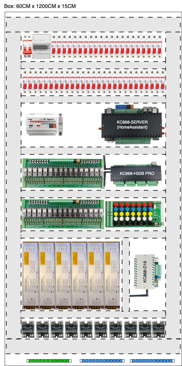

Hi @kincony!
I've been working in this solution. Attached you'll find my proposal for the distribution box.
Do you mind taking a look and make any comments or raise warnings if you have?
Intention is to control 32 Channels (lights, curtains) + 16 Dimmer channels (mix 12v and 220v).
THANKS!!
ok, no problem, just post at here.
