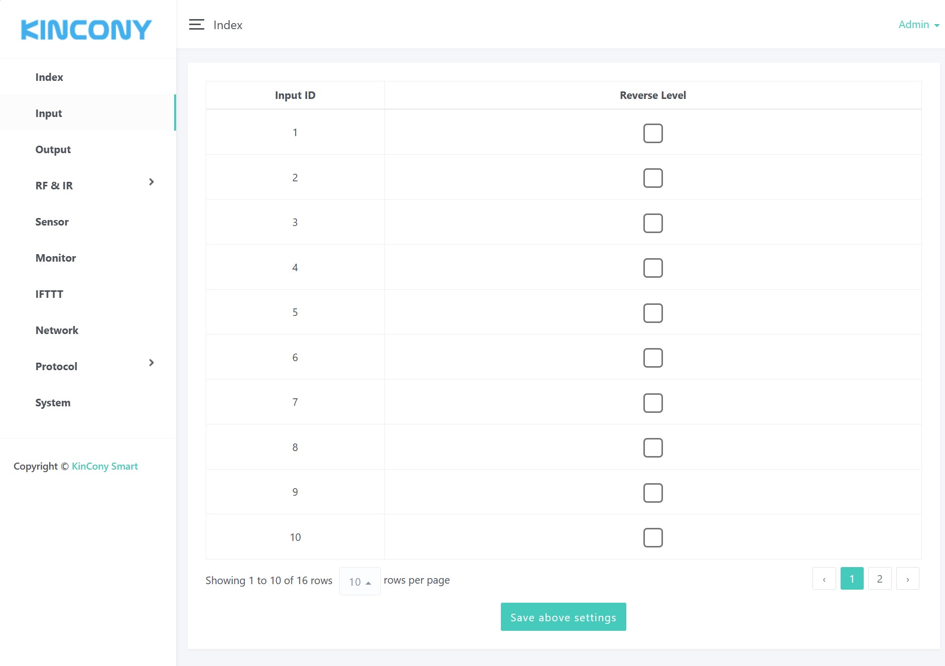

Hi,
I watched the guide and saw there is other options such as bind output, on off toggle.
But i dont see these except reverse. Is there something wrong with the firmware for A16 rev 1.5 board?
Tried both KCS_KC868_A16_V2.1.9 and KCS_KC868_A16_V2.2.2 firmware
[attachment=3708]

KCS v2 firmware use by IFTTT command for INPUT and OUTPUT setting.
maybe you are watching V1 guide. here is V2 online guide: https://www.kincony.com/esp32-kcsv2-firmware.html
(12-13-2023, 04:53 AM)admin Wrote: [ -> ]KCS v2 firmware use by IFTTT command for INPUT and OUTPUT setting.
Thank you, didn't noticed there is different guide for V1 and 2 firmware.
