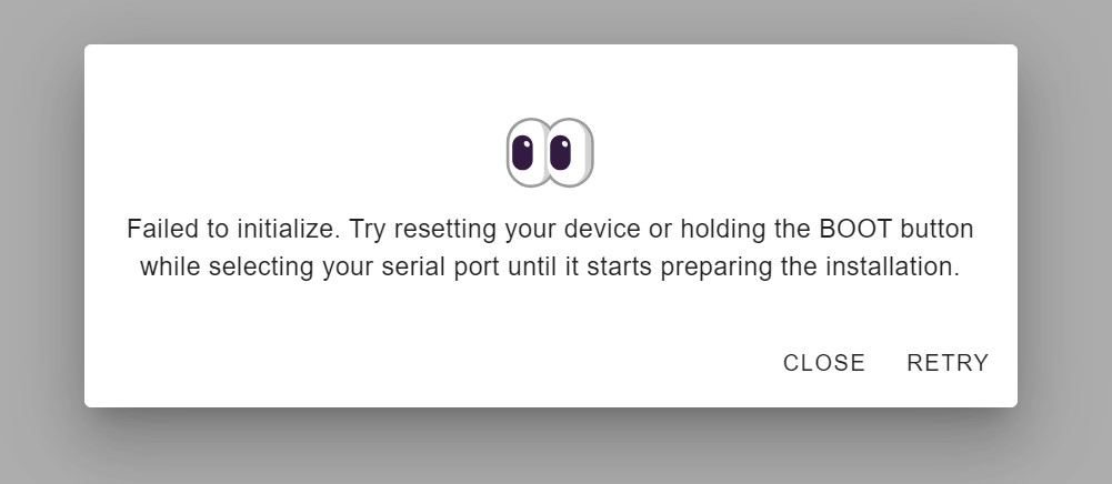

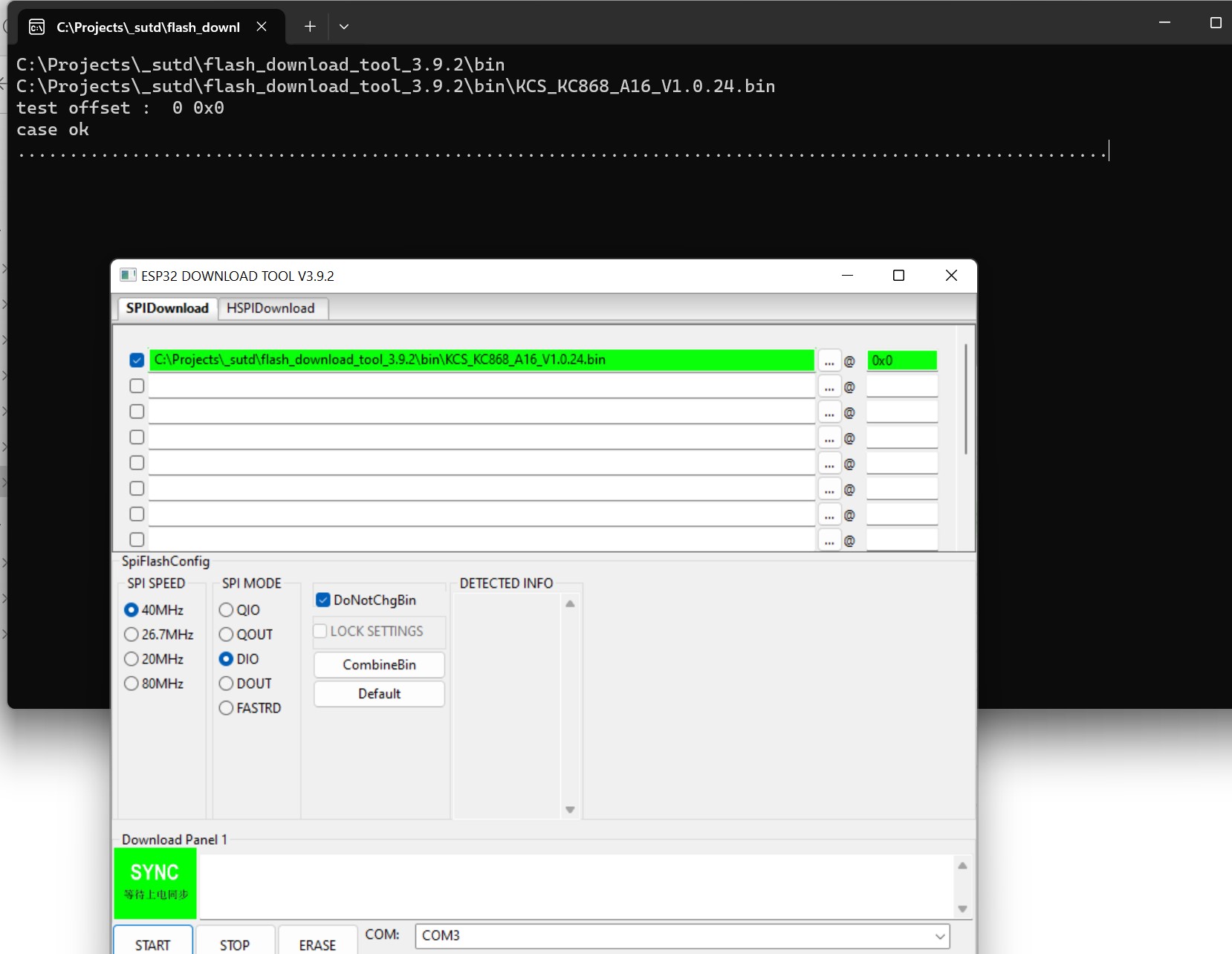

I try using esptool to dump/flash but will not be able to communicate with it
Also try using esphome also same.
Not sure what happened, other a16 working fine so not cable issue.
[attachment=3775]
[attachment=3776]
It will just keep on showing dots
[attachment=3777]

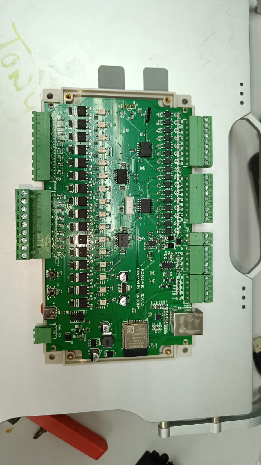

take a photo of your A16 pcb, do you have installed RF 433MHz module?
(12-20-2023, 05:38 AM)admin Wrote: [ -> ]take a photo of your A16 pcb, do you have installed RF 433MHz module?
Hi,
No RF 433 module installed. But we have it.
[attachment=3779]
if can't work, need replace the esp32 module. can you replace it?
(12-21-2023, 02:20 AM)admin Wrote: [ -> ]if can't work, need replace the esp32 module. can you replace it?
i see, now we don't have the tools to do that.
