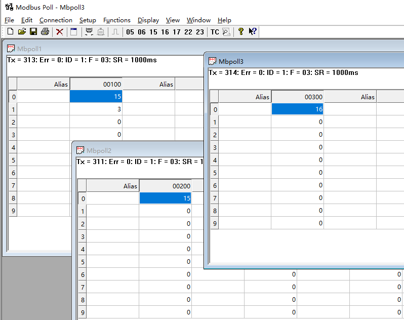

[attachment=3854]
[attachment=3855]
yaml download: [attachment=3856]
modbus pull screen setting:[attachment=3857]
