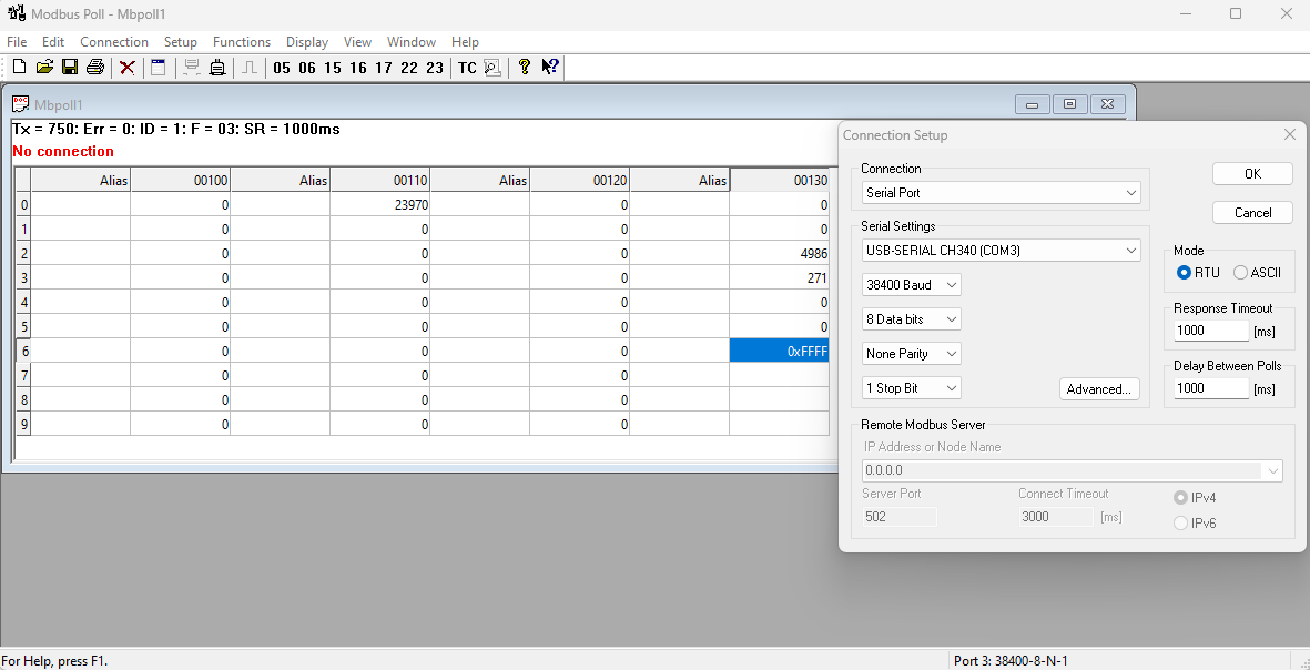

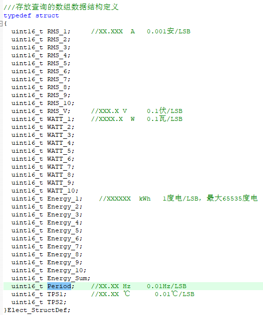

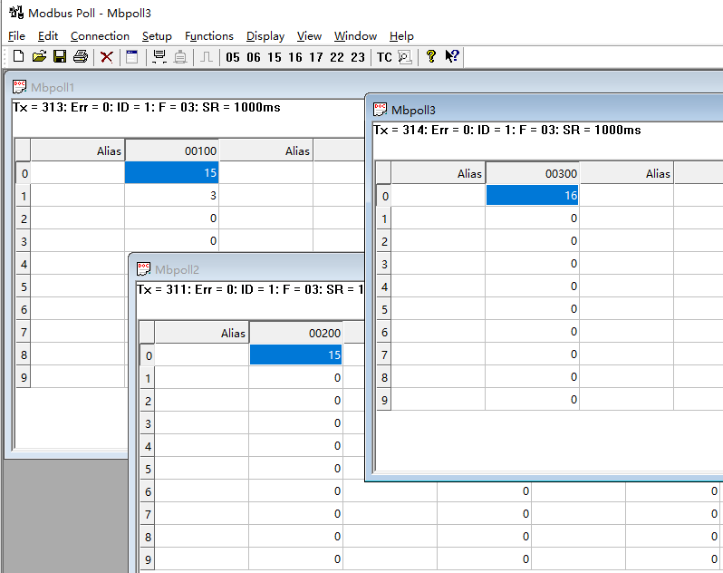

here is M30 data structure and modbus pull screen photo.

3 address with 100,200,300 they are 3 different BL0910 chip.
these data read from RS485 BL0910 chip, it's RAW data.
