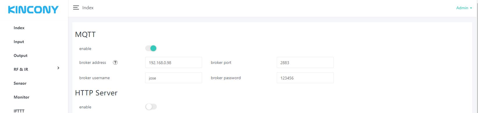

Hi,
I attached two pictures, one with the settings and one with the current status
The port 2883 is the correct port number of my broker
Yamaray
"broker address" you should input "mqtt://192.168.0.98"
But you have input "192.168.0.98", it's different.

Hi,
Thank you for clarifying the point.
Now it is working fine.
