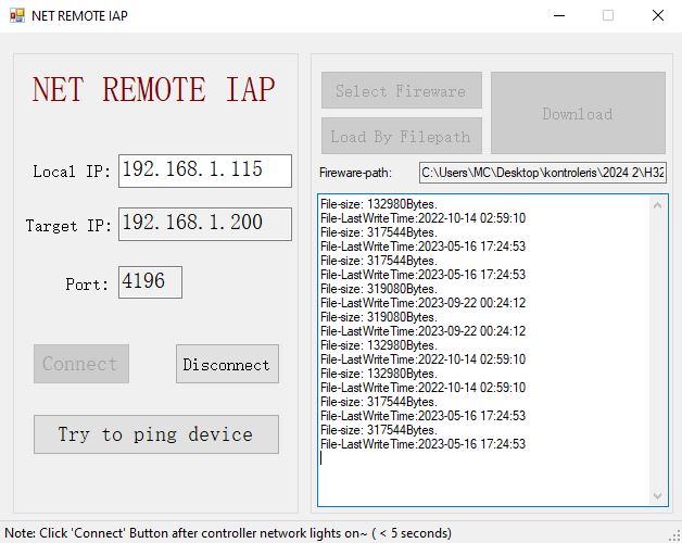

I have H32B which I bought few years ago. I was using it only by "shorting" contacts and everything works, but now I need to add it to HA. I that case I need to update firmware to enable MQTT (I am thinking so). Connecting directly by IP does not work, I hope it will work after update.
Connecting via NET REMOTE IAP works, I connect in 5 seconds after rebooting, ping is successfully returned, but when I choose firmware nothing happens. I have tried different versions of firmware but I am stuck on same result. As I do not know what processor I have, I have tried versions <5.x and >4.4

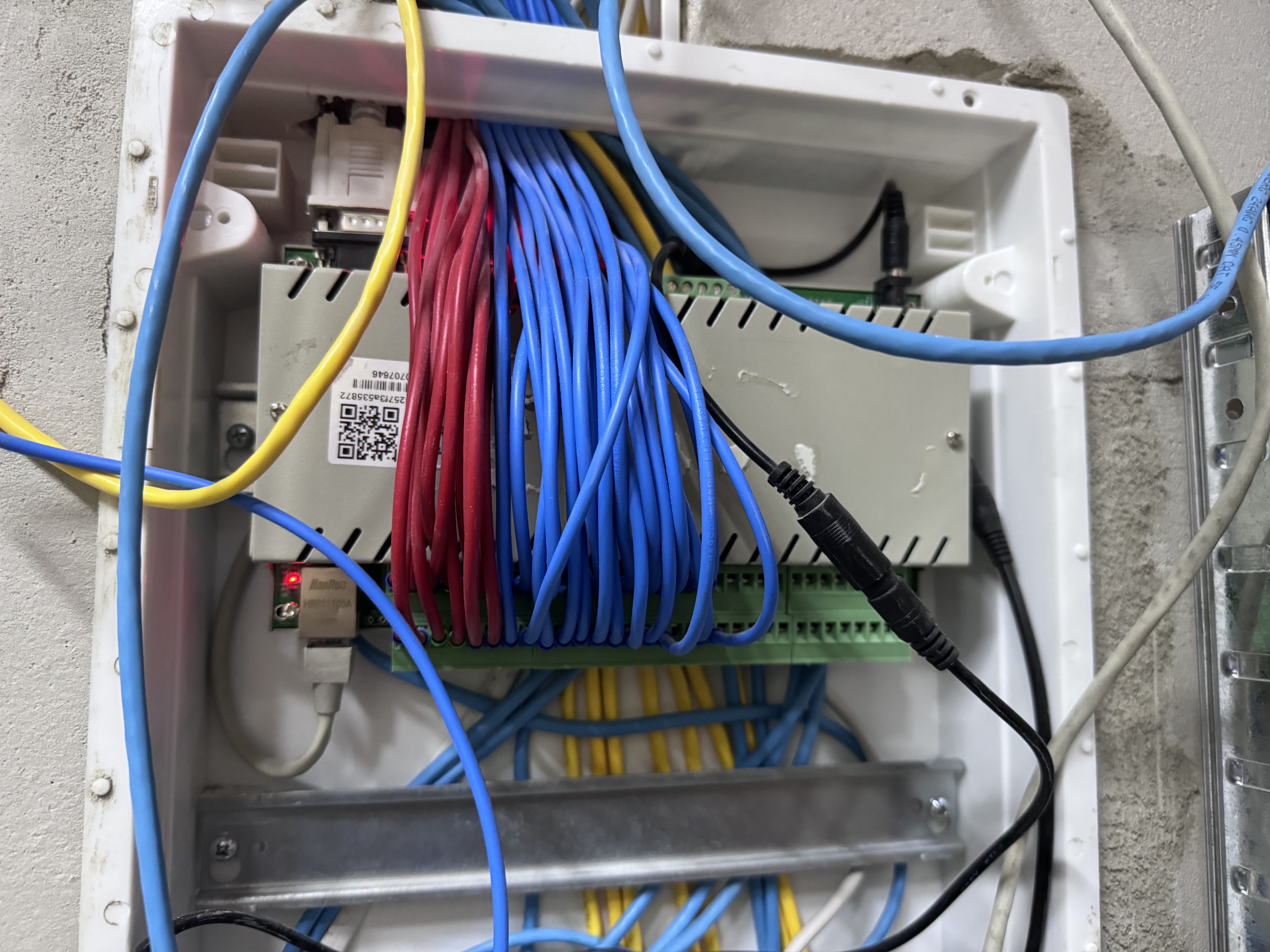

take a photo of your H32B PCB's CPU chip photo.
on the bottom side of PCB,there is a black big chip, take a photo, we want to see model.

Is there any way to tell what chip is used without photo? By serial number or something? Mine board is heavily populated with wires ant it would be huge work only to check what chip is installed.
[attachment=3989][attachment=3990]
you are using KC868-H32L , old controller, not KC868-H32B.
KC868-H32L not have new firmware, you not need to update.
