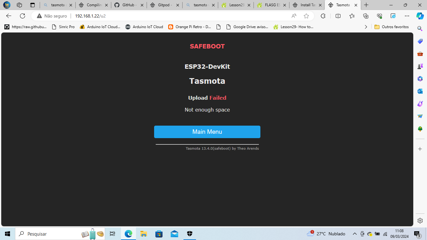

Hello, I tried to do it this way, it loads but when it comes back up a SAFEBOOT message appears and limits the menu options
[attachment=4673]

Hello friend, I followed your steps, but this error occurs, very strange I have already installed more than 20 boards 15 boards of this and only this shipment is not going
