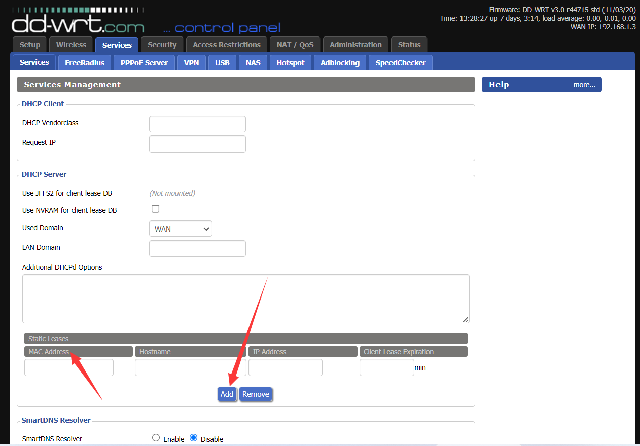

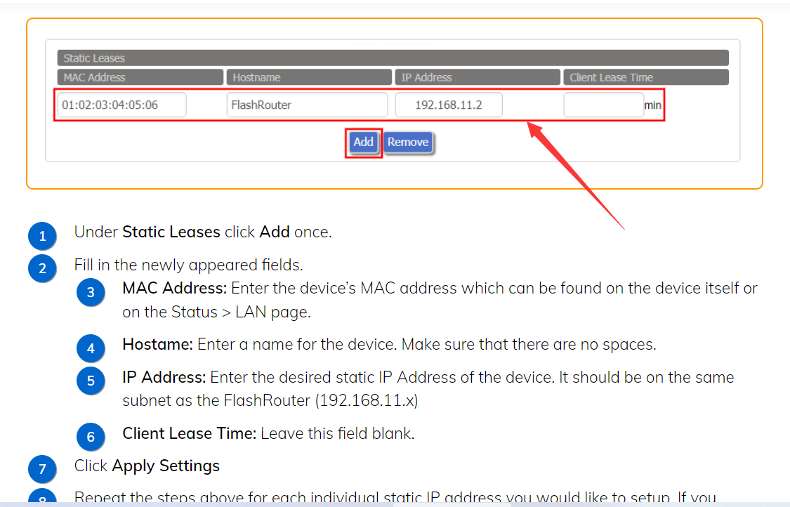

KCS firmware no static ip option for WiFi, But you can set a Static IP for KC868-A6 in router according to board's MAC. for example, this is DD-WRT system router, there is option:
[attachment=4991]
[attachment=4990]

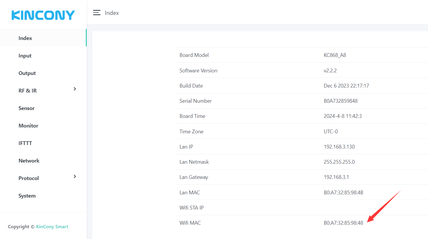

check your KC868-A6 MAC address in KCS webpage "INDEX" page.
[attachment=4992]
