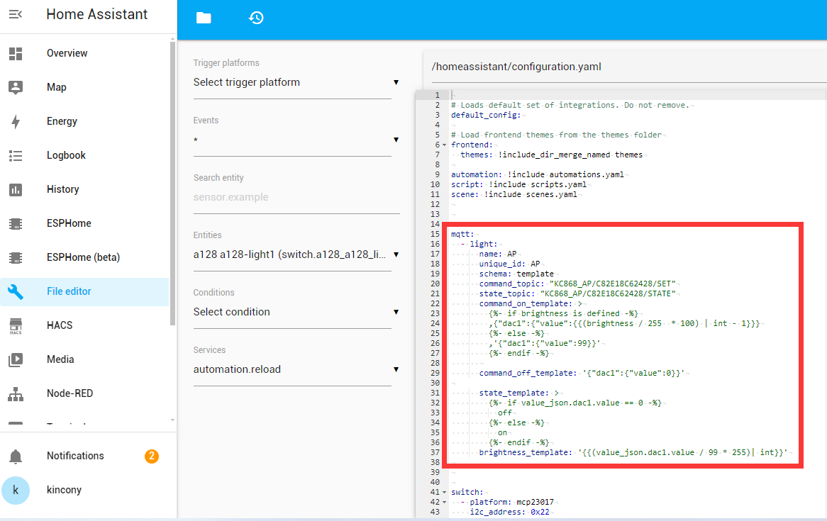

sorry, these days very busy. i have config KC868-AP channel 1 by MQTT, but not enough time to change the number of precent, you can modify it. now the code already can work in home assistant.
[attachment=5134]
[attachment=5135]
[attachment=5136]
config file download:
[attachment=5137]
