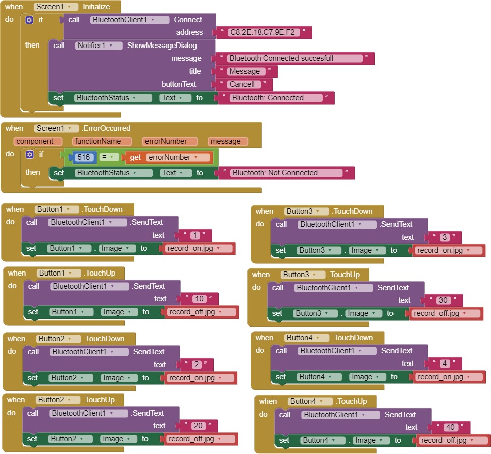

I'm trying to program four momentary switch via bluetooth commands. I don't understand why I can't enable  "Relay3".
To compile KC868-A4 code I'm using "Arduino IDE". To program Android code  "MIT App Inventory" .
 Here is the codes I Used.  Can some one help me to understand where is a mistake ? Tank You.
AI Code [attachment=5142]

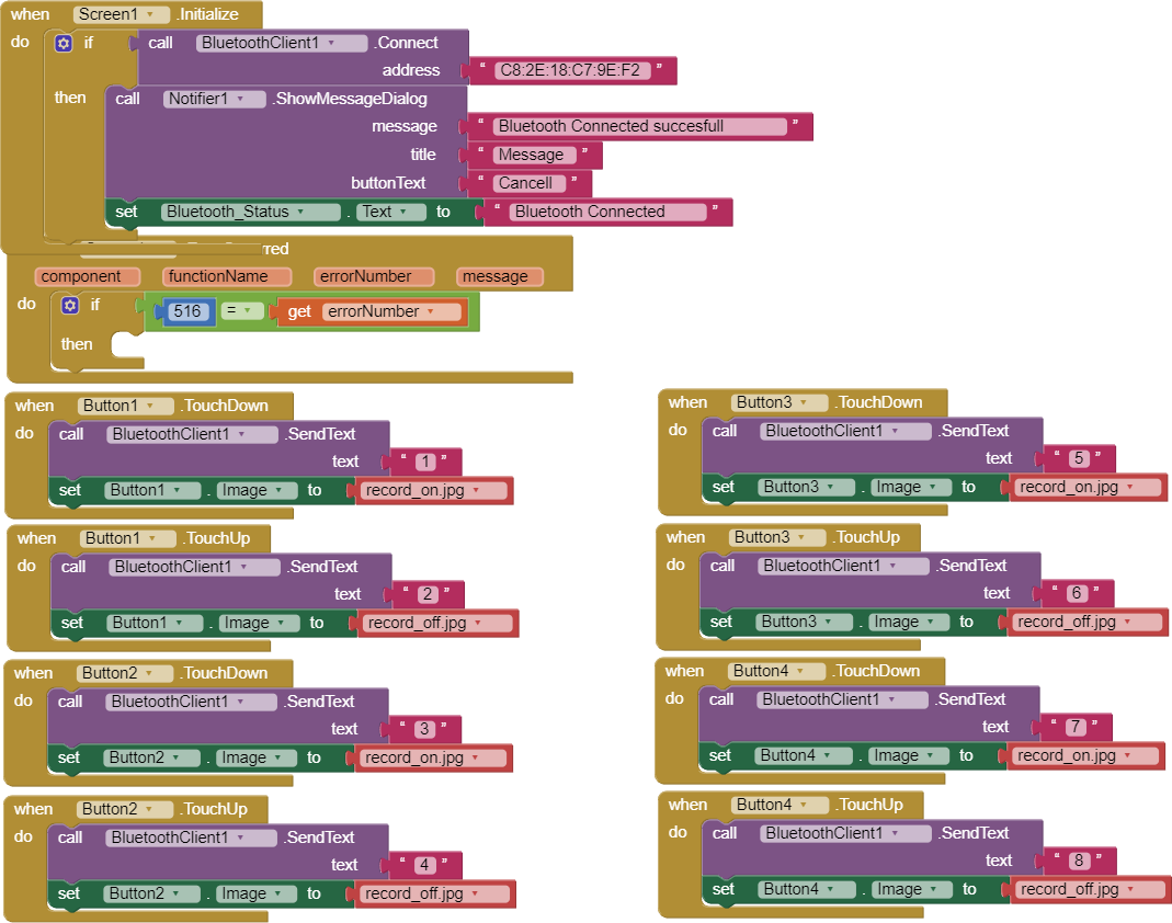

(04-28-2024, 12:50 AM)admin Wrote: [ -> ]this is KC868-A4 relay control by bluetooth arduino demo code, you can test it: https://www.kincony.com/forum/showthread.php?tid=1647
I solved in this way:

In attachment   Mit App[attachment=5193] Inv. Blocks
