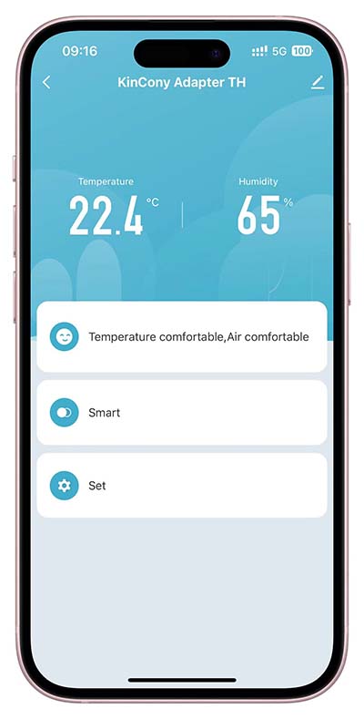

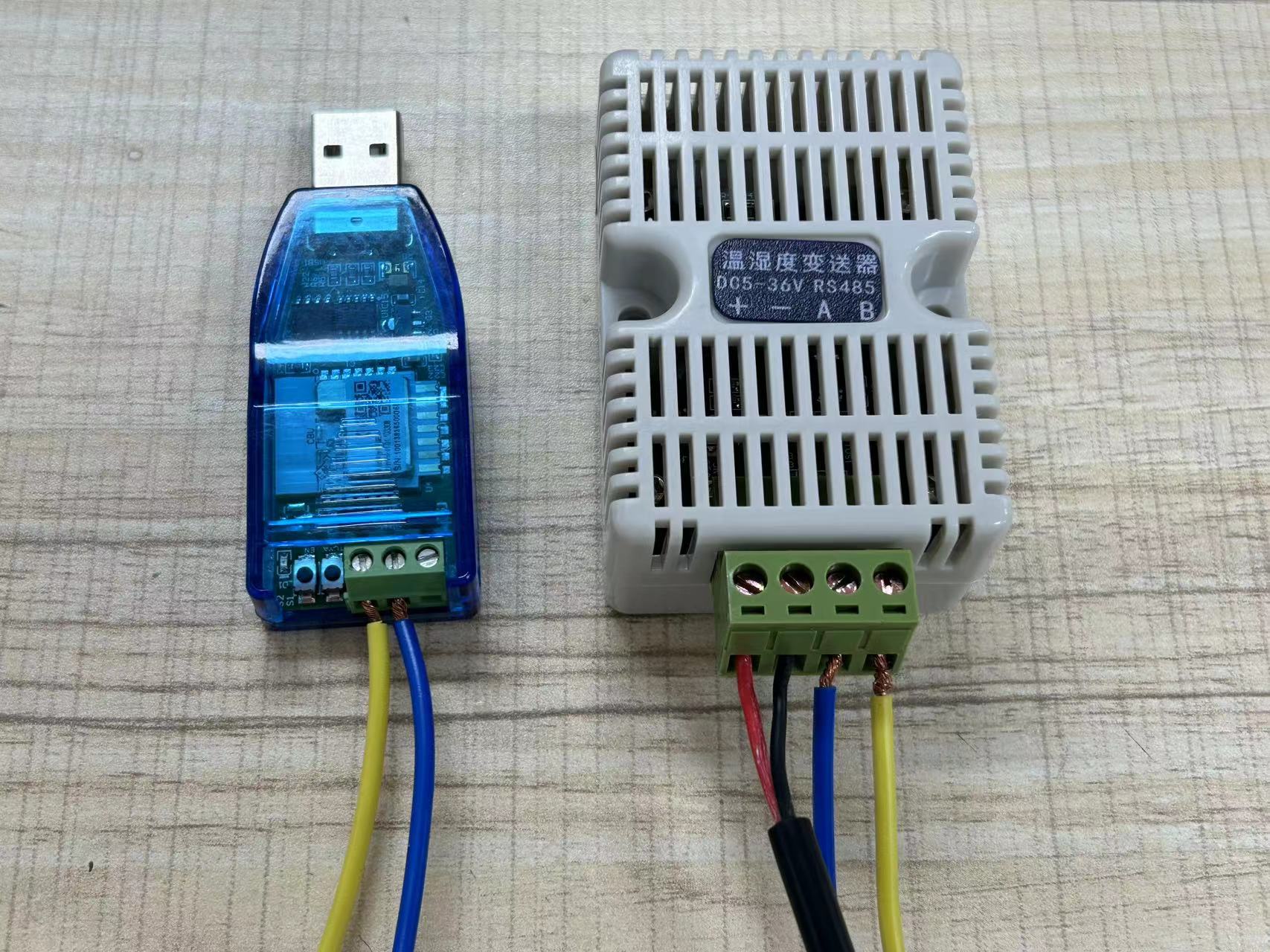

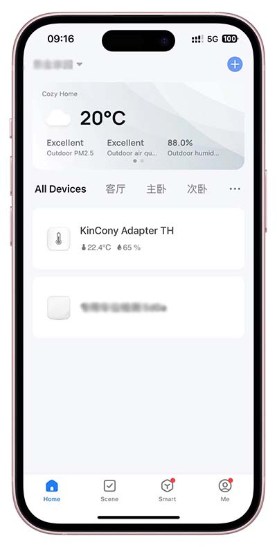

let your own RS485 temperature and humidity sensor can work with Tuya app, so that can remote monitor sensor data and make AUTOMATION by Tuya app via internet.

Hello there. I just received my Tuya adapter V2, and flashed the exactly same code (copy-paste) to read my xy-md02 sensor via Arduino IDE. Although i get the corrent readings on my usb to rs485 sensor (when querying the sensor with modscan32), on IDE's serial monitor i get Result:humi.<221.00%> temp.<0.00°c>. Can you plz help me troubleshoot my issue?
because different sensor have different protocol, you need to modify source code according to your sensor's protocol.
After a lot of searching and studying i managed to get the right values to the serial monitor. My problem now is that in smartlife/tuya app i get the correct value only for temperature. Humidity is stuck in 26%. Sensor is 100% responsive in serial monitor and tuya app as well. DP_IDs used are 1 for temp and 2 for hum. Can you help me troubleshoot please?
my_device.mcu_dp_update(DPID_TEMP_CURRENT, temperature, 1);
my_device.mcu_dp_update(DPID_HUMIDITY_CURRENT, humidity, 1);
these two command use for upload sensor data. you can change the vaule upload to tuya app, check whether work well.
By changing the following i recieved the correct updated humidity value. Thank you once again!
my_device.mcu_dp_update(DPID_HUMIDITY_CURRENT, humidity, 2);
ok, good.
