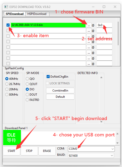

download KCS firmware firstly:
[Image: esp32_download_tool_2.png]
(06-01-2024, 10:53 PM)admin Wrote: [ -> ]download KCS firmware firstly:
I already did that.
Followed https://www.kincony.com/kcs-firmware-esp32-board.html and https://www.youtube.com/watch?v=9w8Ek4uB
And I used KCS_KC868_A4_V1.0.24.zip firmware (of course after extracting it) - https://www.kincony.com/forum/attachment.php?aid=2252
take a video how to done, send to whatsapp number: +86-15381188302
