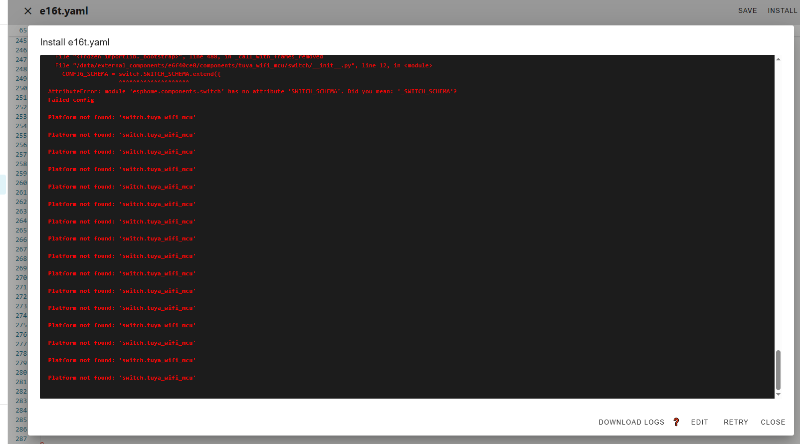

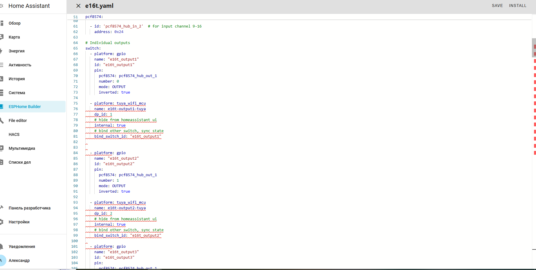

I tried to upload this file to my e16t via Home Assist, but I get an error at the very beginning.
Please help.
because ESPHome 2025.2 have update. use this new yaml file:

I did it as described above. an error occurs when trying to download the configuration file. the logs are attached[attachment=9039][attachment=9040][attachment=9041]
