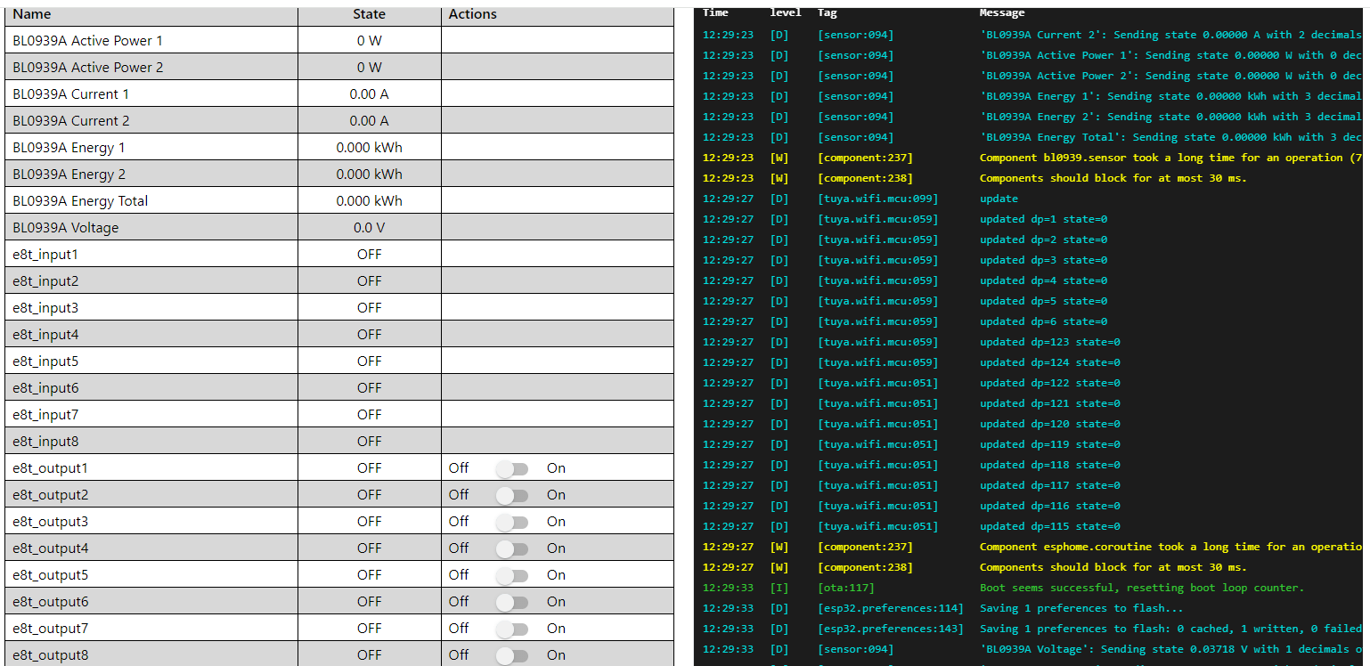

06-05-2024, 04:32 AM
friendly_name: e8t-tuya

web_server:
port: 80
download yaml file: [attachment=5344]
[attachment=5345]
