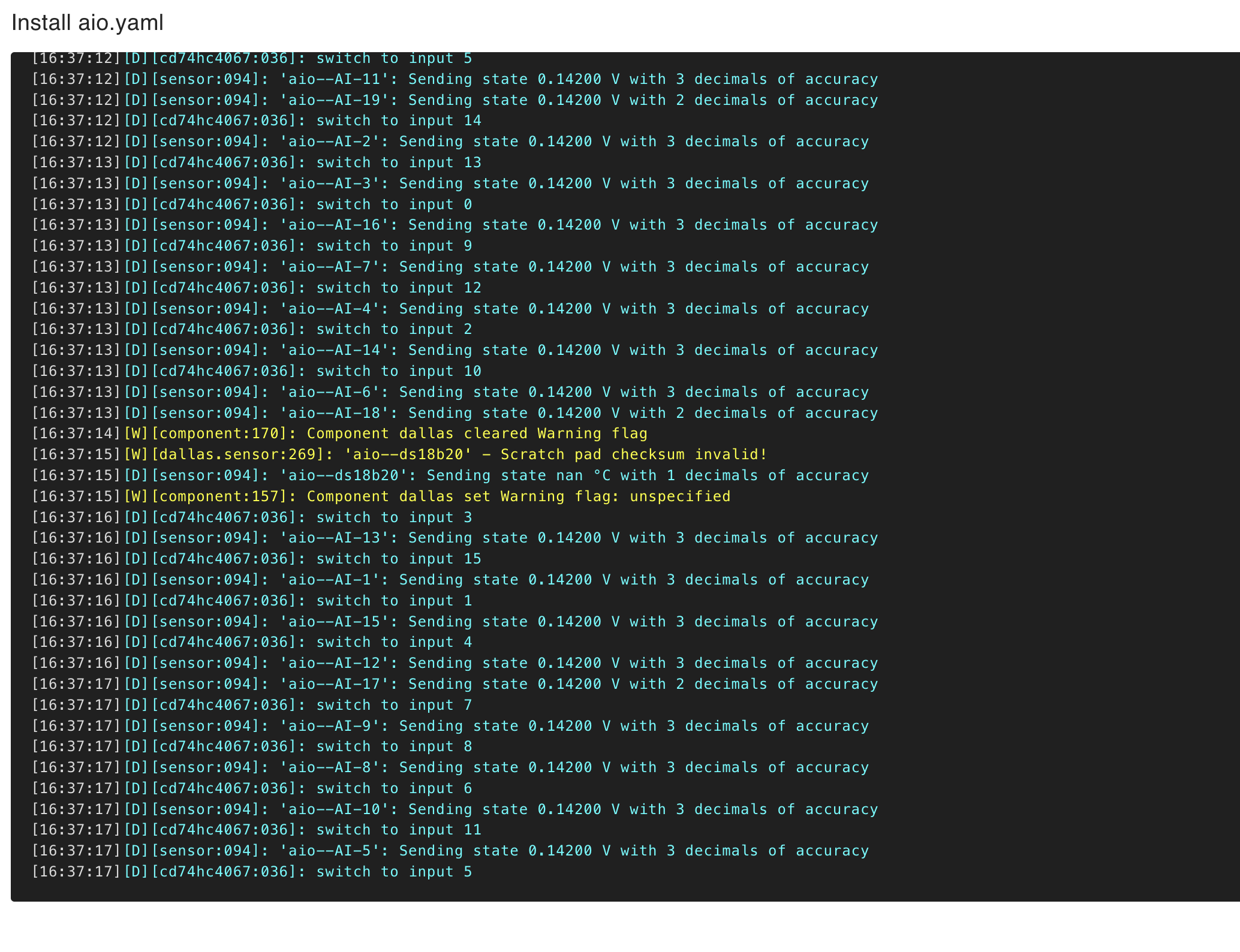

[attachment=5397]
I have been trying to install a Dallas temperature probe on the AIO board and have been unsuccessful. I used an Arduino Uno and a sketch to retrieve the address of the 10 probe(s) I purchased and as I got the address I marked a number on the probes to keep them identified. I tried two different probes, red lead to +3.5V, Black to GND and tried both IO pins 4 & 5 to no avail. I get an error in the logs that I have no idea what to do with.
take a photo , how you wire your DS18B20 with AIO board.
I found the error The DS18b20 address your AIO config program discovered was not the same as the address reported by the discovery sketch that was used on my arduino.
sure, every DS18B20 have different address, you can't use my address. you need discover find your own sensor's address, then replace in yaml file.
