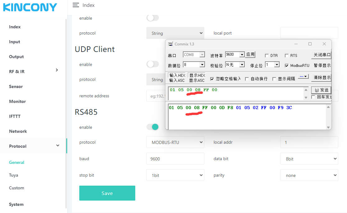

V2 firmware use IFTTT command for INPUT link with OUTPUT. my means, you can test V2 firmware, whether you can use modbus command for 9-16 channel output.
(06-20-2024, 10:31 AM)admin Wrote: [ -> ]V2 firmware use IFTTT command for INPUT link with OUTPUT. my means, you can test V2 firmware, whether you can use modbus command for 9-16 channel output.
OK
i have checked with OUTPUT9 with modbus command, it's OK.
[attachment=5464]

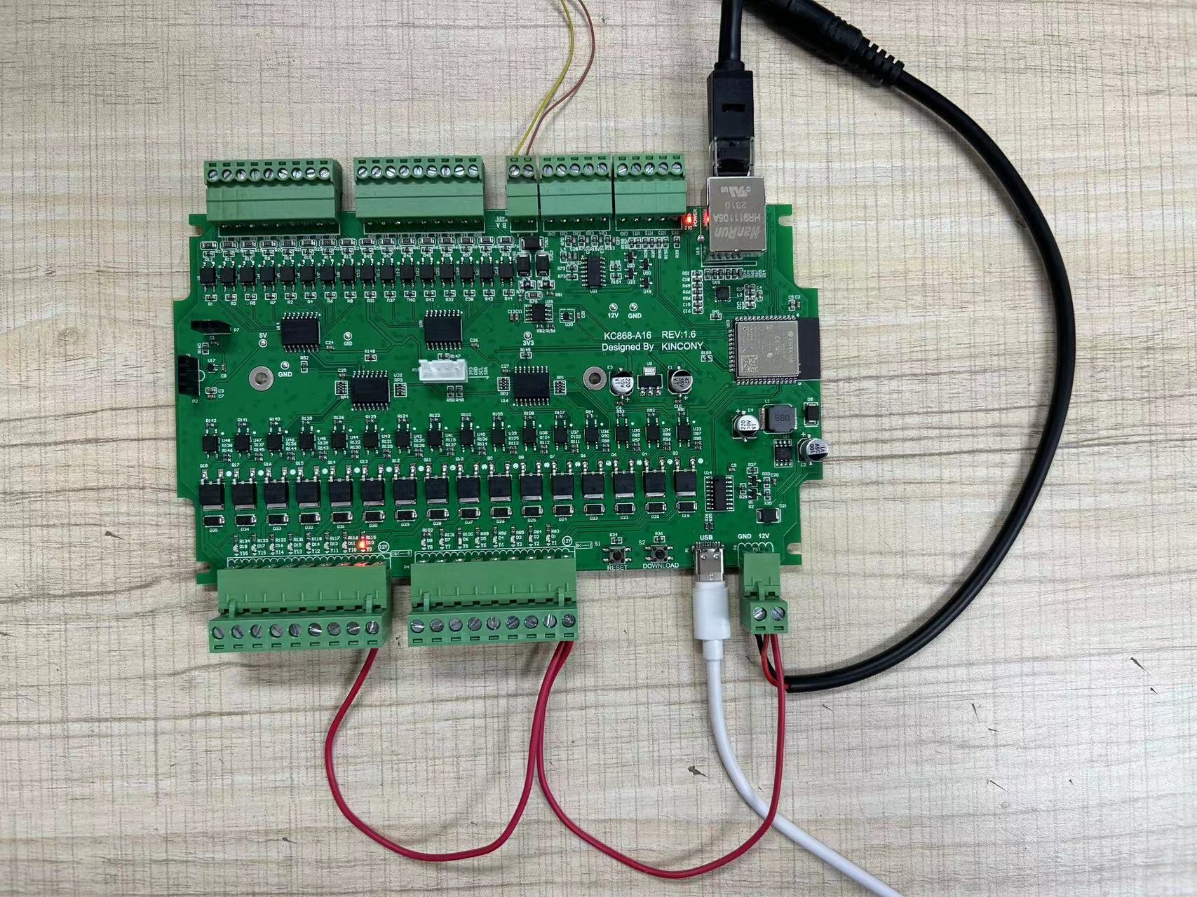

can you take a photo how you connect wire with your A16 board? whether you have connect the RED wire as mine?
[attachment=5465]
Ok, i'm tomorrow send video
