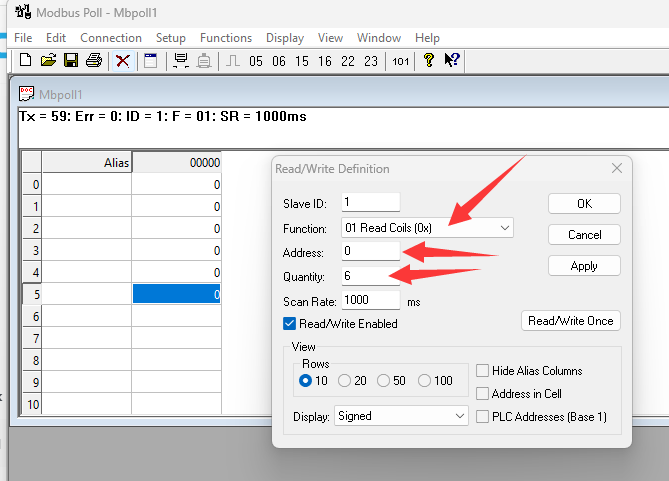

here is tested result with modbus pull:
[attachment=5456]

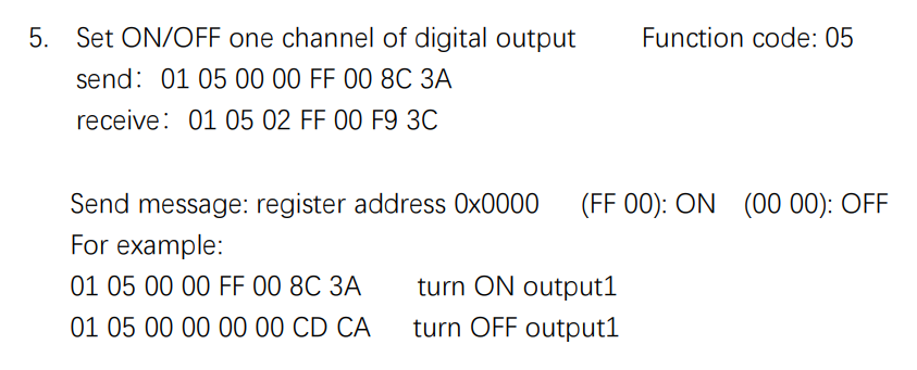

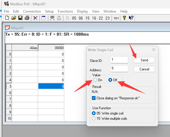

enable RS485 modbus RTU protocol on KCS webpage firstly. then you can use relay ON/OFF command for testing.
[attachment=5457]
[attachment=5458]
you can see the relay1 is ON. here is modbus pull setting:

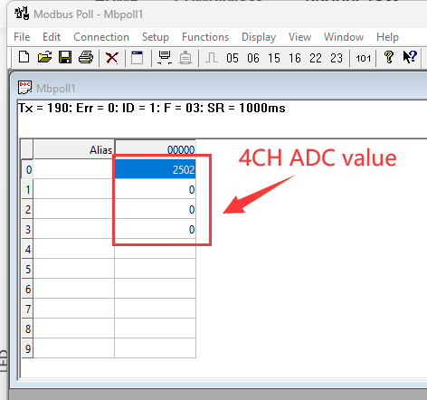

here is read ADC value command:
[attachment=5461]
read 4 registers by modbus pull:
[attachment=5462]
[attachment=5463]
ADC1 have connect with 3.3v dc from KC868-A6 board.
