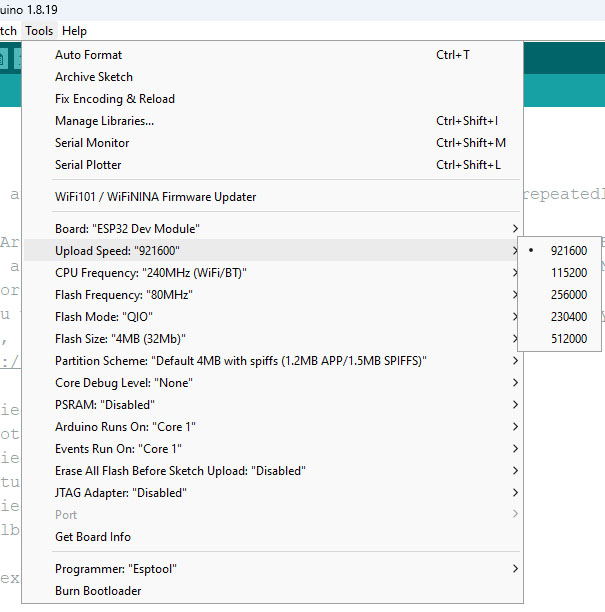

I downloaded Arduino IDE and after struggling installing serial port driver, I finaly managed to see NodeMCi-32s on COM3.
But it seems no communication is possible with the board as I have an error message when I try to send some commands  :
Invalid FQBN: getting build properties for board esp32:esp32:nodemcu-32s: invalid value '460800' for option 'UploadSpeed'
Compilation error: Invalid FQBN: getting build properties for board esp32:esp32:nodemcu-32s: invalid value '460800' for option 'UploadSpeed'

you can check with this photo.
[attachment=5563]
