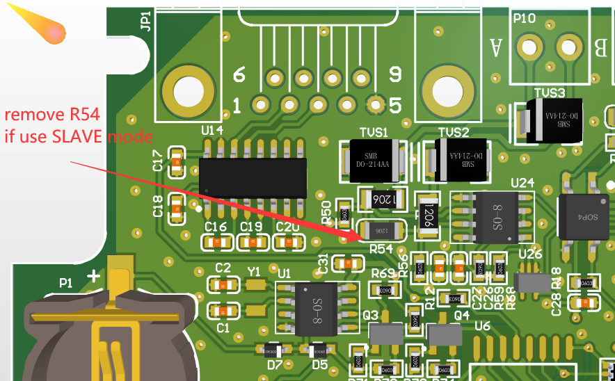

because there is R54 120ohm resistance installed on PCB. that is set for A6 board with "MASTER" mode. if you want A6 board work with "SLAVE", you can remove it.
[attachment=5609]
(07-16-2024, 09:40 PM)admin Wrote: [ -> ]because there is R54 120ohm resistance installed on PCB. that is set for A6 board with "MASTER" mode. if you want A6 board work with "SLAVE", you can remove it.
Removed R54 on the A6 board.
Now the hardware run ok; I mean:
a) slider moved to ON at homeassistant dashboard --> relay ON at A6 board immediately
b) slider moved to OFF at homeassistant dashboard --> relay OFF at A6 board immediately
